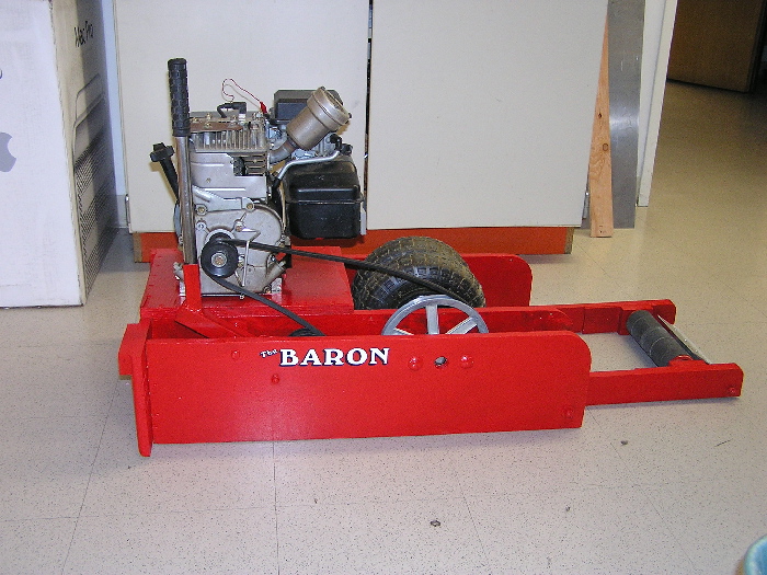

As I had horrible cranking backfires with the kickstarter last year, this is how I'm working around that problem.
$100 in bearings, pulleys, wheels/tires, and shafting plus an old 5hp gas motor equals 20 mph rear wheel spinning.
Starting up is a dream now rather than a potential blower repair...
Robert in California

I love it. A bit big to get in my very small camper van though when going to hill climbs with the bikes on a trailer. There's a similar contraption regularly in use at those to persuade a Vintage Douglas in to life amongst other things.
