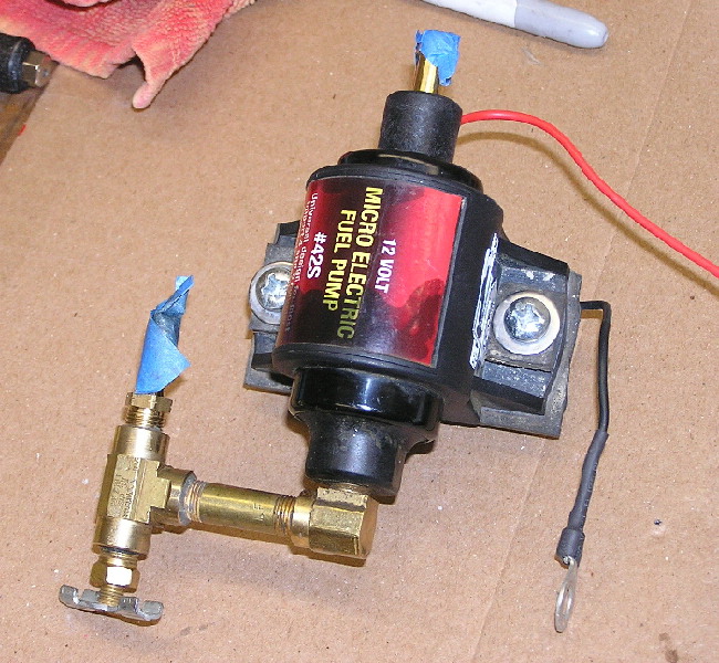

This past Sunday the Supercharged Morini failed to run at El Mirage's second race because of a fuel leak as seen on the stained pump label....
The makers of the race gasoline say to drain the system after use to prevent issues... I have done that, however a check valve in the electric fuel pump I'm using looks like it held enough race fuel to cause a problem ....
I plan on flushing the pump with regular car gas from now on....
