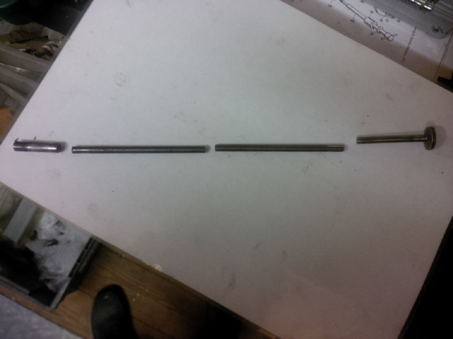

Hi folks,
I'm putting my strada back together and have been let down by my lack of photos and notes yet again!
Can anyone confirm that the clutch pushrod parts are in the correct order in the photo?
Bob

that looks in correct order, the smaller rod goes gearbox sprocket side , two of equal length in the middle, mushroom pushrod in the clutch side, so as it is in the photo.
Posts: 927
Re: clutch push rod
Sometimes, in the "modern" motors, you can find a little ball (?) in between the push rods. That makes the clutch a bit easier to measure (theoreticamente).

Thanks guys, I was pretty sure I had it right but always good to get conformation.
