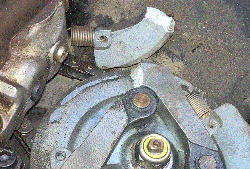

Thanks for your input. I took the engine cover off today to find
That one of the electric starter shoes has sheared off.
I sent NLM a photo and they have never seen one break like that
Before. I'll buy a new one. I assume its as simple as removing the
Serclip and swapping over?
Ben

This forum is dreadful. How on earth are you meant to add photos if they are to only be 256kb??
anyway,here is what's left of the photo to show you the break.
Posts: 1457
Re: worrying new noise.any thoughts?
At least it was only a peripheral component. I think it is as you say for a single shoe.
