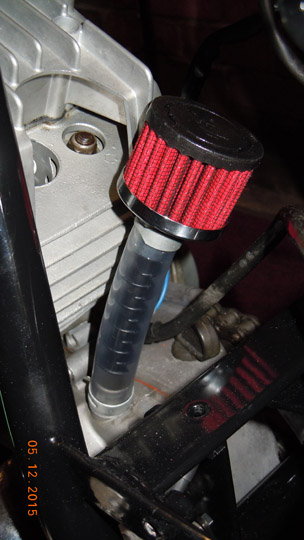

				Posted: 18 Feb 2016 17:30
				by TurboRestorer
				My breather setup & seems to be OK, doesn't smell of hot oil after a run anymore. Only had one air/oil seperator ever since we owned the bike.
Was warned that you have to have the separator fitted!!
- DSCN4323.jpg (73.57 KiB) Viewed 7315 times
