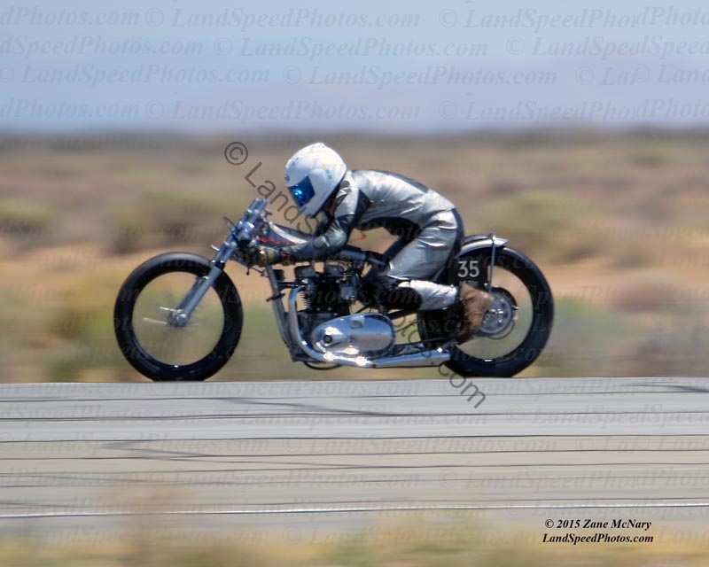

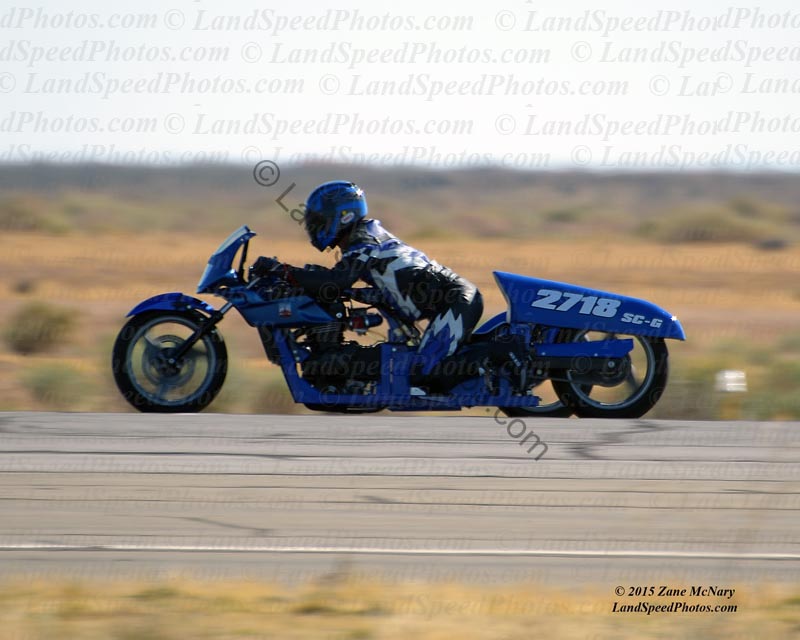

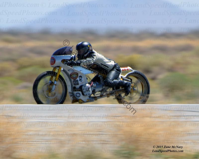

Take a look at these bikes,,, They all have one thing in common in that the Supercharged Morini is faster that all of them, and is getting faster every time it goes out now....

- 750cc triumph well prepared racer from Switzerland
- 150808589.jpg (77.95 KiB) Viewed 4342 times
- 500cc dohc kawasaki kneeler sidecar racer
- 150808088.jpg (83.57 KiB) Viewed 4342 times
- 500cc flat twin running on Methanol
- 150808414.jpg (75.07 KiB) Viewed 4342 times
