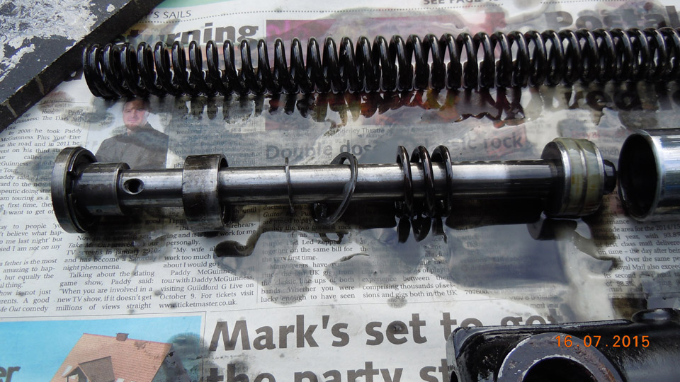

Strada damper assembly stripped.

Excellent. Thank you. The damper rod should drop out, and it did on the second leg. The collar is rusted in in the first leg.
