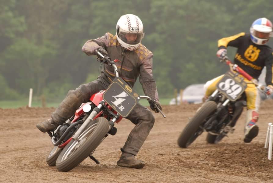

I have an 81 350s that i threw together for the first race meeting on the new Greenfield Dirttrack oval 2 weeks ago, It went ok with one heat win and 4th overall on the day, I was disappointed with the acceleration out of the corners, so i investigated, I found the compression down to only 80psi on both cylinders, further inspection found the pistons and the bores to be .004" and .005" under spec. with big ring gaps, My quandry is which bore size to go for, nlm only have 3rd over size or 375 pistons. Then there is the german supplied 400 kit, i don't need top end speed as we only use 2 or 3rd gear dependant on the track size. good acceleration is what im after. Can anyone offer me any first hand comparisons ( not what your mates mate said please) of the merits of the different options available + any other tuning tips to someone new to morini's. As a footnote i do have a newyork 507 engine in the wings that i have just started stripping to check all the tolerances, bores and pistons have been measured and are bang on spec. I am also looking for exhaust tuning tips as i need to make something suitable (poss 2 into 1) as soon as i can get a full engine back into the frame, regards. Harry
