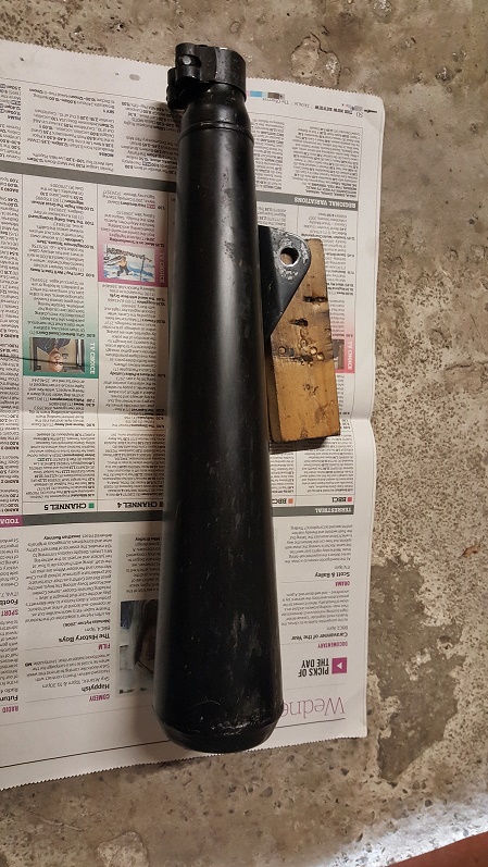

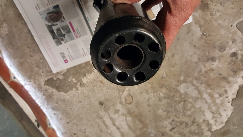

Thanks guys. Yes i do have the drawing George, The header is quite short at 570mm but easily made so i will give it a try, i did cut my silencer down to roughly the same dimensions as the drawing but left i bit in the middle, as Chris at Nlm had mentioned they like a bit of back pressure? Must admit most of my road race engines megas where open. A test i remember well was done by a great tuner Leon Moss ( who sadly died when a tarmac roller went through his windscreen on the way to work) He did all the testing for Superbike magazine on a proper water brake dyno. They spent 2 days on Mark Forsyths Rotax 500 single that has twin exhaust ports, they found that 22" was the best for a good spread of power or multiples of 11" But for best mid range and only a bit less top end they found 18 and 22 where a good combo. So maybe thats what Morini were up to. If anyone has an old set of 350 header pipes going cheap i would be very interested to hear from you.
				- 20160811_094517.jpg (115.54 KiB) Viewed 22169 times
				- 20160811_094456.jpg (185.98 KiB) Viewed 22169 times
