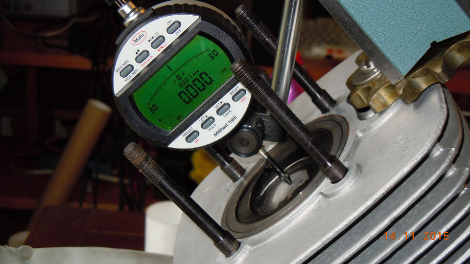

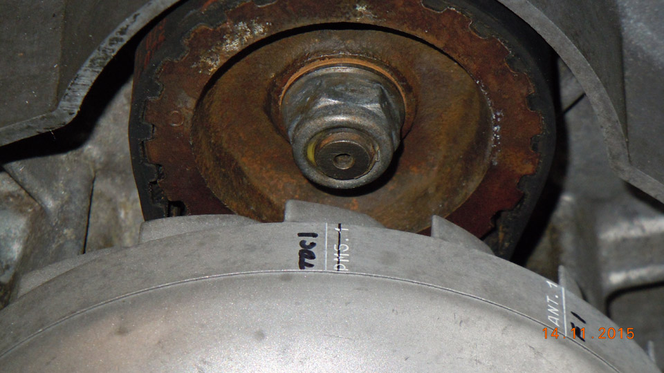

I used a DTI to find TDC & found rotor timing marks to be 1.5 - 2deg out.

I have two 78 models (pre electric start) and as far as I know, the difference was in what style of flywheel you have.
Prior to the electric starter bikes, they all came with a machine finished flywheel (as per your avatar) that referenced the punch mark at "9 0'clock" - this is for both TDC and max ignition advance. A simple check with a protractor will show that the PMS1 and ANT1 marks are 34 degrees apart.
With the introduction of the electric starter bikes, the flywheel became die cast with a drum for the starter shoes and the timing case gained the window at the top. On these, all references are to the cam centre line.
Where things can get muddied (and I don't know the whole story) is with the Kanguru's and Camels, which gained the die cast flywheel but not the starter drum, and these also used a timing cover very similar to the earlier kickstart only bikes.
The waters are made even murkier in that the 500 flywheel and stator will bolt straight onto a 350, and while the TDC marks remain the same to cam centre reference, the max ignition advance is less. (30 degrees instead of 34 degrees!)
With a 40 year old bike, unless you are lucky enough to have owned it from new, there is no guarantee that you still have the original flywheel on it.
So, back to your original question, would it run OK? For the tappets, the difference of approx. 90 deg of crank rotation (= 45 deg cam) in terms of cam lift could give a bigger than thought inlet valve clearance but not by much, while I would not expect to see any appreciable difference to the exhaust clearance.
For the ignition timing, I doubt it would run with the timing 90 deg out.

Thank you for clearing some points up for me. I rechecked my timings on my 1977 Sport which has no starter and they are all taken from the "9 O'clock" mark. Using a strobe confirmed that all was well when using that mark. I just had the horrible feeling that I had set timing from the "9 O'clock" mark but PMS1 and PMS2 from the cam centre. This however must not be the case because once I started to get the carbs closer to balance the bikes power said hello and also the whole in the rev range at around 4500rpm also vanished.
