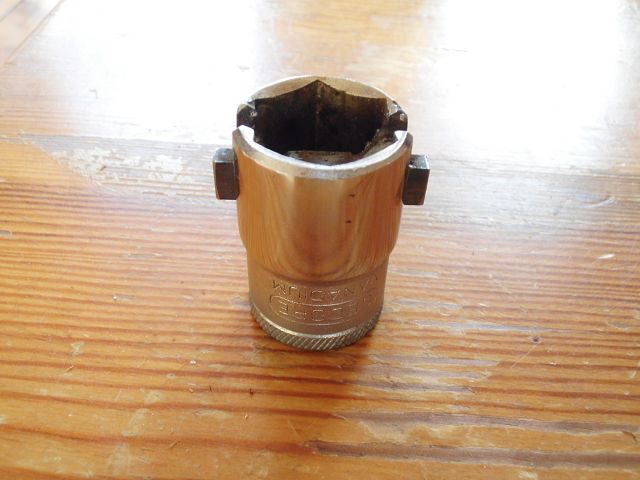

I made myself a tool to get theses stubs out and in, using a nut that just enters in the tube. To get it out one should try it with a warm motor (if posible) or a bit of heat anyhow. With this tool you can do that best when the motor is mounted in the frame to be able to aply maximum force, and it has de advantage that the opsition of the sluts in the tube doesn´t matter, what sometimes can be a problem if you try it with a simple pieco of steel.

norbert wrote:I made myself a tool to get theses stubs out and in, using a nut that just enters in the tube. To get it out one should try it with a warm motor (if posible) or a bit of heat anyhow. With this tool you can do that best when the motor is mounted in the frame to be able to aply maximum force, and it has de advantage that the opsition of the sluts in the tube doesn´t matter, what sometimes can be a problem if you try it with a simple pieco of steel.
Thanks for the tip. I used a 1" piece of steel pipe and key stock. I cant remember the key stock size though, maybe 3/16's JIC anyone needs the same tool.
