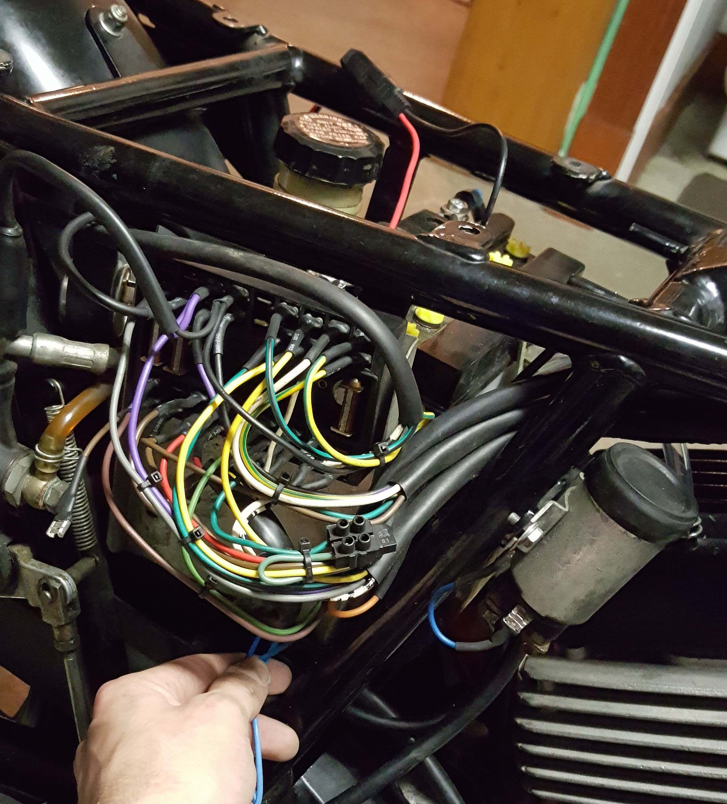

				Hi so I am new to the "italian" bikes but I am having an issue with a spark. Bike has (2000miles) on it, and was running before hand. All connections have been redone (New clips), will post a photo of the fuse panel harness.
- Fuse Box Panel

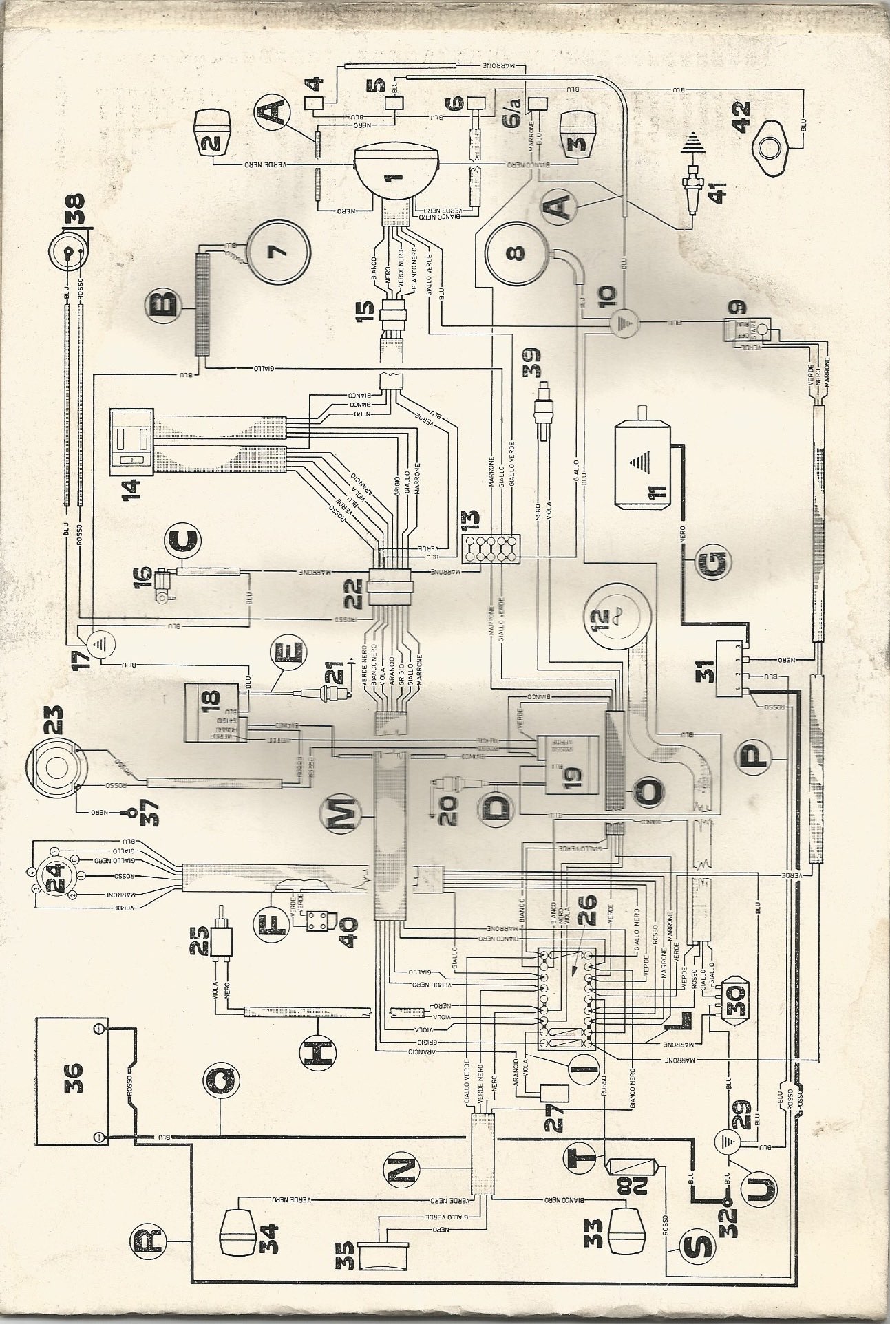

Now every single line is inserted into the correct pin as per from the wiring diagram. I posted the wring diargram from the original manual (NOTE: their are very faint lines inbetween SOME pins that are connecting said pins togeather within "fusebox").

One issue is (12V) are coming out of the stator (alternator) YELLOW Wires. If im correct only AC should be exerted ONLY when the bike is RUNNING???
So I am wondering if there is anyone who can help me out on this issue and has any experience with this electrical system or possibly this may be the wrong manual? the bike is a 350 K2 but is their a possibility a different electrical system on a different year or half year....
