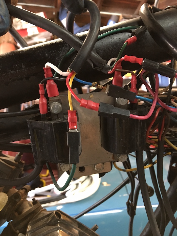

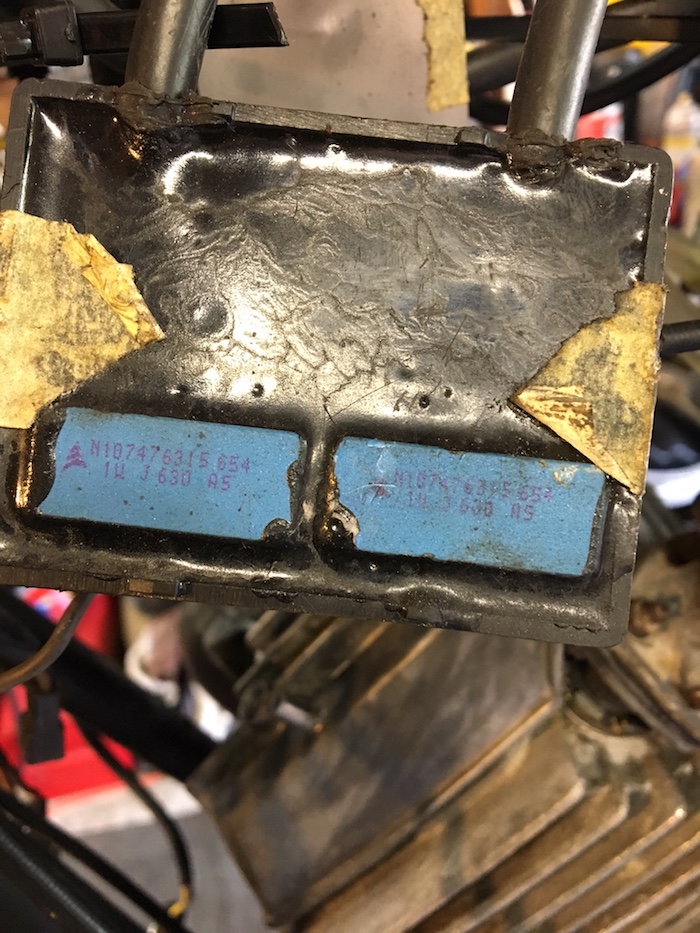

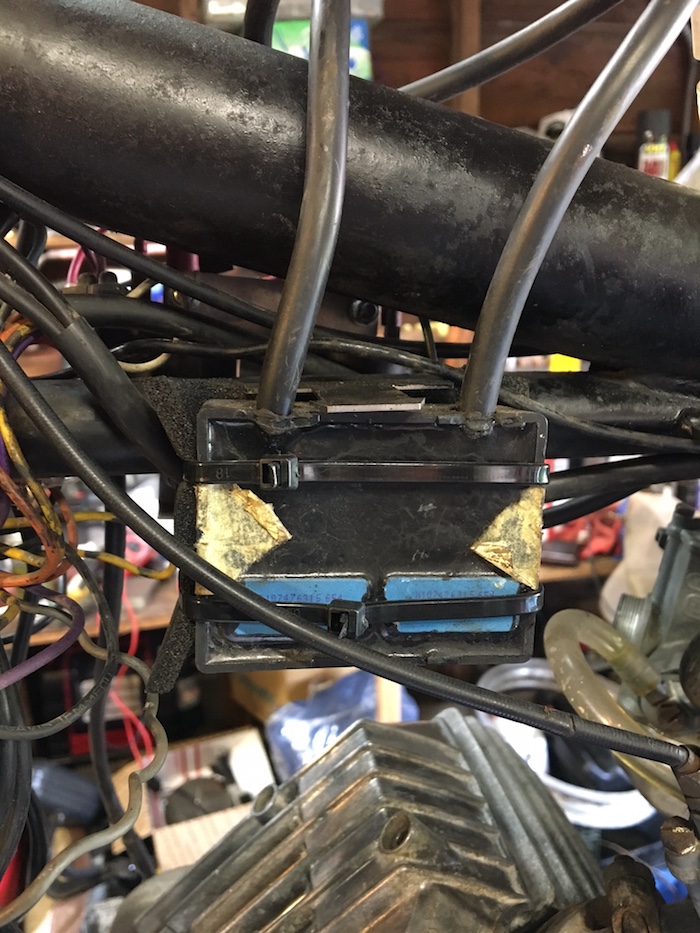

Hi All,
My 350's PO did some wiring mods and I'm a little confused about how it's supposed to go. The bike ran when I got it, but didn't have a battery or key/ignition switch (at least not a key) - nor did it have any kill switch. I put a key switch in - 4 terminals; I doubled up the grey and brown accessory/light wires just to get it going. Green goes to alternator/stator and the red winds up at the battery both via the fuse panel. The blue (ground)isn't used, the switch grounds itself.
Now, with the key turned on, I get 12v to the lights (br and grey) and the green wires where they end up at the ignition pack, but after I got things squared away, now I have no spark. After some reading, I think I have a different setup and hopefully haven't fried it with the battery.
I didn't make any drastic changes, just cleaned it up and figured out what was what. I'm hoping I just grounded something that wasn't supposed to be (the missing kill switch) but I'm not having any luck. This pickup/transducer setup is a little foreign - every way I know how to test a points system doesn't work.
Questions:
What is this setup? Is the box a single transducer for 2 individual coils?
How can I test? I read 220 ohms at the coil from + to - but I don't have any resistance.
Is the 12v that gets connected to green at the keyswitch right?
Thanks in advance.

First thing, that ignition system is not the Morini original. It looks a little like the NLM system BUT! it isn't quite like the NLM system I have on mine. So possibly another persons work if not a earlier/later version of the NLM type.
The important points are;
1) You don't want 12 volts anywhere near the transducer/black boxes! The Standard and NLM system is self generating via the flywheel/stator.
2) If the components are good, then make sure your green wire is not earthed. That is how the standard system switches the ignition off.
3) All the stuff you know about points and coils is irrelevant here!
4) If you have given the transducers/black boxes 12 volts they will most likely be fried, as you said.
5) If you don't have a full understanding of the system and some very specialised kit you won't be able to test much of this other than by substition.
Sorry that's all a bit negative sounding and hope you get round the problem.
