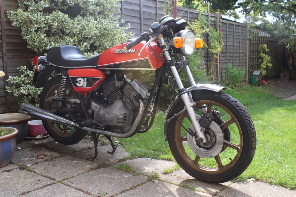

I have just rebuilt the top ends of my beloved 1977 3 ½ Sport and got her running again after a long seven-year hiatus (and it’s wonderful to hear that bellowing engine note again), but before I go any further and start randomly spending out, I would very much like to hear your thoughts.
She just won’t idle. I’ve made many adjustments and replaced parts, and things have improved but there is always the inevitable slowing and then stop. In the real-world environment, with heavy traffic and accelerate-brake, the cutting out is more pronounced and common. It’s kick-start only so it takes a little while to get running again – too long for impatient car drivers.
I have read the 3 1/2 forum extensively and so far have made the following changes/adjustments:
Fit new spark plugs
Balanced carbs – idle screws and cables (with gauges)
Adjust fuel mixture screws
Fit new pilot jets - first 50s, then 45s, then 42s
Check and replace all seals in carbs, including choke seals
Adjust carb float height to spec
Check and adjust ignition timing with timing light
It’s at the stage now where it will idle for a good 2 mins, in a controlled environment; well, the garage. However it is prone to changing speed, and always eventually slows and stops. I wonder if the Morinis are vulnerable to the slowing because of the light flywheel and ignition which retards itself to prevent kickback? Just an idea.
The ignition timing session was interesting. Essentially the more I advanced the pickup, the faster and more stable the idle got. It’s currently set at the ANT mark at idle. I know this is massively wrong (and haven’t ridden it) but setting it to spec means it will hardly idle at all, and is also difficult to start. Otherwise, it would appear to be advancing and retarding as normal.
I would like to use the original ignition setup but I’m wondering if it is getting tired. I like the idea of the bike running independently of the battery but am considering NLM’s setup if it gives me a reliable idle.
Any thoughts or advice would be appreciated. Sorry for the long post – I wanted to give the best idea of my current situation.
