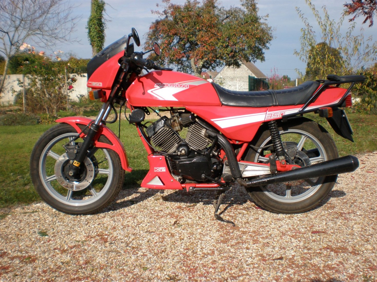

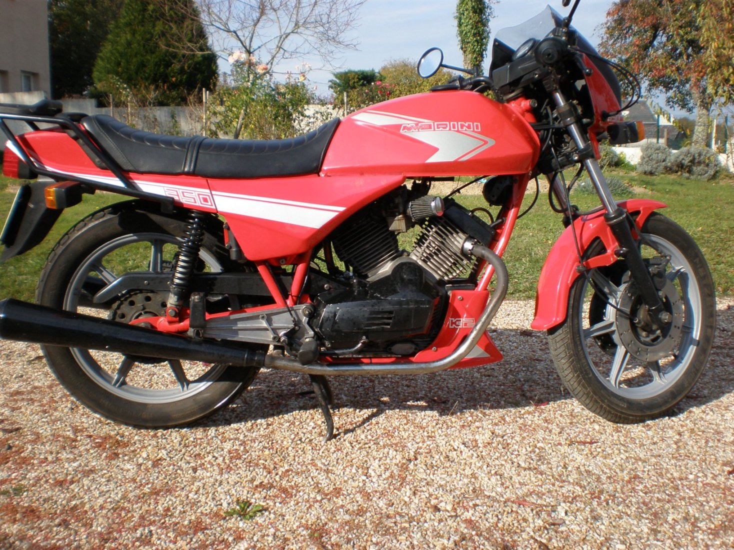

Well, that's my excuse.
I've recently taken delivery of a 1986 K2. Still assessing it, looking OK so far, though the oil was black and seemed a lot more than 2.5l. There's evidence of some enthusiastic use looking at the footrests and the odo has 50,000km showing. It's fitted with pod filters, but the original airbox is still under the tank. I emptied about 5l of smelly old petrol out of the tank, together with a load of rust. I'll change the belt next and have a look at the electric starter. More news as it happens.

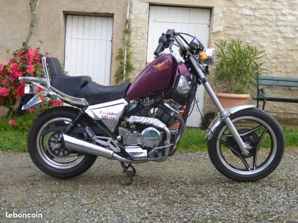

Hmm - I wonder if I could push my dear wife to another 'project' (besides the 250) - this has just turned up, running and registered... :twisted:
