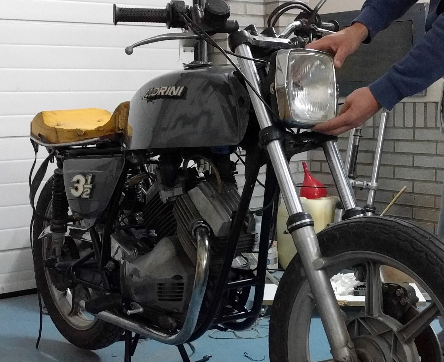

My name is Jose. I am Spanish morinista. My brother and I are restoring a 1974 tree e mezzo. (attached a pic)
we are about to finish such an adventure, but kinda stuck in the electrical wiring (I think a very easy task), let me explain:

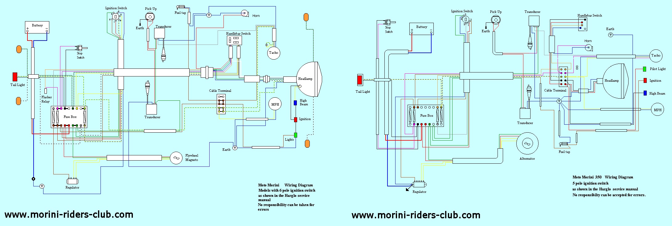

What made me confuse on the rectifier connections are the wiring diagrams (find attached below). As you guys can see, in the "6 pole wiring diagram" (the one on the left hand side of the picture), rectifier is not represented to be connected to ground, on the contrary, on the 5 pole (on the right) it is painted to be connected to ground (the arrow to ground tells me that).

I think the rectifier is always grounded to the chasis by the srews that fix it to the frame. The brown cable goes to the main switch and gives the reference of 12 V to the regulator/rectifier. If the batterie is real down the regulator does not work.

Back to the diagram, I assume that the 6 pole is not correctly described then,
