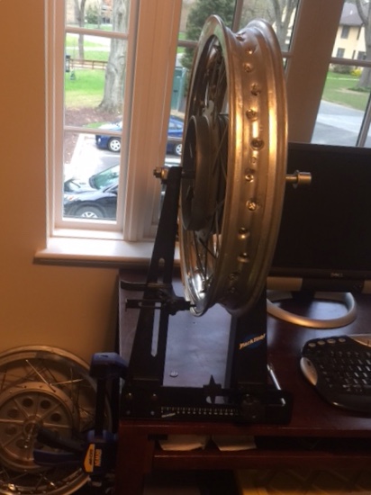

It sounds like the wheel is dished if one side sticks out further but the rim is centered. I’ll borrow a dishing tool, fit the brake and sprocket and check.
I got the front rim true within 1mm. The rear rim should be close to that when done.
- F62DB3AB-B575-4B40-A60C-37AED4969487.jpeg (71.44 KiB) Viewed 4519 times
