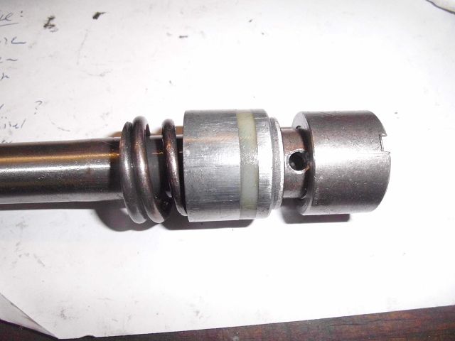

Here are some fotos of the dampers
This are the usual marzocchi dampers without the two plastic sealing rings (there are models with only one but wider ring)

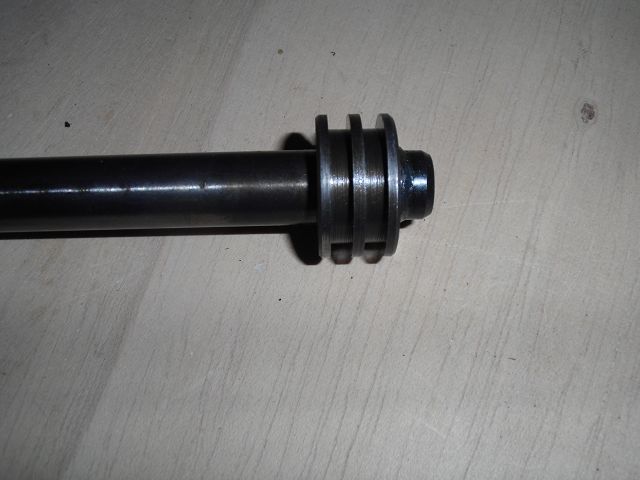

Re: Mazocchi Fork length(s)
This ones I found in a fork of a 74 Strada (stanchion over all 615 mm) drumbrake
A friend found the same damper in a Sport from 75. I think this is a Paioli damper but not 100% sure. Would be interesting to see a damper from a 250 V that used Paioli forks. As told above the tappet on top has another thread as the Marzocchi forks and the bottom valve also is different (longer an inserted deeper in the tube)
The Paioli forks have better fame then the Marzocchis. The reason must be the aditional top valve. When i mounted this fork in Dulcinea I put in 200ccm of SAE 15 like I´m used to. After 100 km I changed for SAE 10 and it became a bit better but still a bit hard. Now I´ve read that the Paiolis (at least for 250V) need 160 ccm of SAE 7,5.

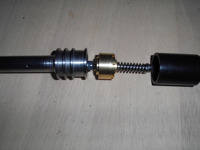

Now I changed for the damping sistem from Sören with regulable top valve (design from Paul Camton), which I put in new stanchions (605 mm) for Marzochhi forks using SAE 2,5. Still have not done a test ride.
