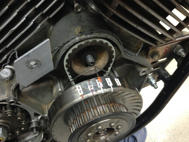

Polybelt with kevlar cords.jpg (197.88 KiB) Viewed 15707 times
Hello Lads,
The Supercharged Morini hopes to be ready for the 2018 racing season opener at El Mirage California in two weeks...
After much repair and refurbish in the off season, the Morini will be using a new timing belt I found.... Polymer body with kevlar reinforcing cords...
The Bike will be running without fairings this time out, and hope to set a new record for the class... I'll need to hit 108 mph to take the record.
Motor needs a bit of running to free up from the new bits installed...We'll see how it goes

Well guys, I'm finally getting back to you about the new belt that I have been running.
1- it works
2-it goes on-off easier than the rubber belts.
3- it needs a couple of degrees of spark timing lead to put the timing where you want it.
I'd say that the timing needs to be checked with a timing light at high rpm (6k) to know
for sure where the timing is with all slack pulled out of the system.
4- below is a link to the supplier:
https://shop.polybelt.com/124L075-Polyu ... 075FPK.htm

But, but did you dyno test it with that belt and exactly the same state of tune but with a Kevlar belt ? ;)
The 'timing moving around' concept is intriguing. Though I'd have thought that once a Morini strobe timed properly was WFO at the red line it wouldn't make much difference, until the belt started to wear significantly perhaps, in which case regular strobe checks would be in order.

I once ran a belt long enough on my Sport that it was over the maximum 6mm slack limit and the idle was getting quite unreliable.
The idle was much more stable as soon as the belt was replaced, but the timing jitter at full advance didn't seem to change.
The camshaft pulley of course came in three grades, A, B and C to enable use of sorted and graded, rather than selected belts. Selected belts would have been quite expensive.
That doesn't mean there were three distinct sizes of camshaft pulley (or belts), there would have been size variation in each grade. A small B grade pulley paired with a long B grade belt might be slacker than ideal.
I've seen a tensioner pulley mounted to the back of a specially made alternator stator plate. The plate could be rotated on extended adjustment slots to set the tension.
