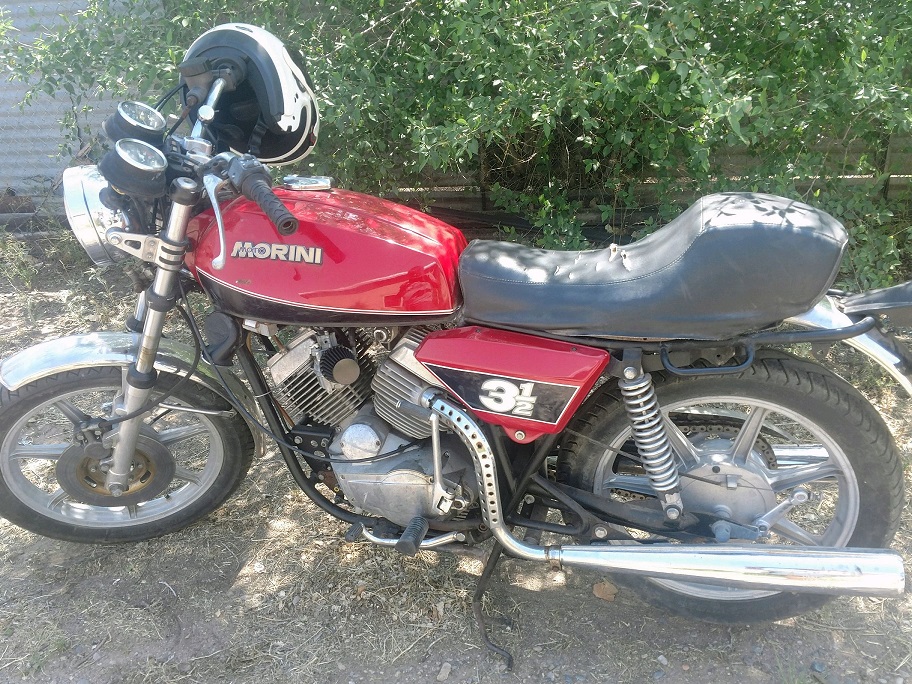

I fell in love 20 years ago with a 78 Morini 3 1/2 that a relative owned. He was an importer and rider of trials bikes. Followed along as he died and left it to his kid who rode it for a bit and left it to die in his backyard. Drunk dialed him one night last year and made a deal to buy it, sight unseen. Engine stuck, handlebar bent but looking surprisingly good. 11K miles. Freed the engine with patience, changed cam belt, cleaned and synced carbs and it's now a rider.
A3 Frame, S on the engine. Serial Number 14743
Now to my questions.
It doesn't have clip-ons. Instead, it has regular handlebars. How hard is it to find the upper triple tree to convert it?
I don't know if it was changed or if this was something that was done in some markets. It does have left hand shifting.
That would probably necessitate rearsets and I would want to covert to RH shifting.
Glad to be a member here as I'm thinking this will be a great resource. I'm in Albuquerque, New Mexico and I don't know how many others are still on the road here.

Having a Sport with clip ons, and though I don't find them uncomfortable,if I had regular bars I'd probably keep them on.But it looks like you have a fine bike.

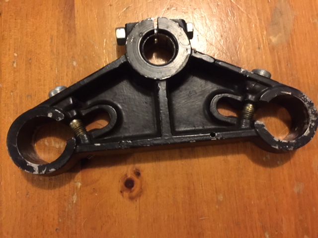

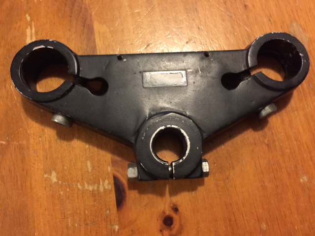

I have an upper triple clamp from a sport. It’s black and good condition. $100 + 8 priority ship. PM me or email - mark@markepstein.net
And thank you for bringing another one back to life.

Clamp looks to be in good shape other than needing a fresh coat of paint.
