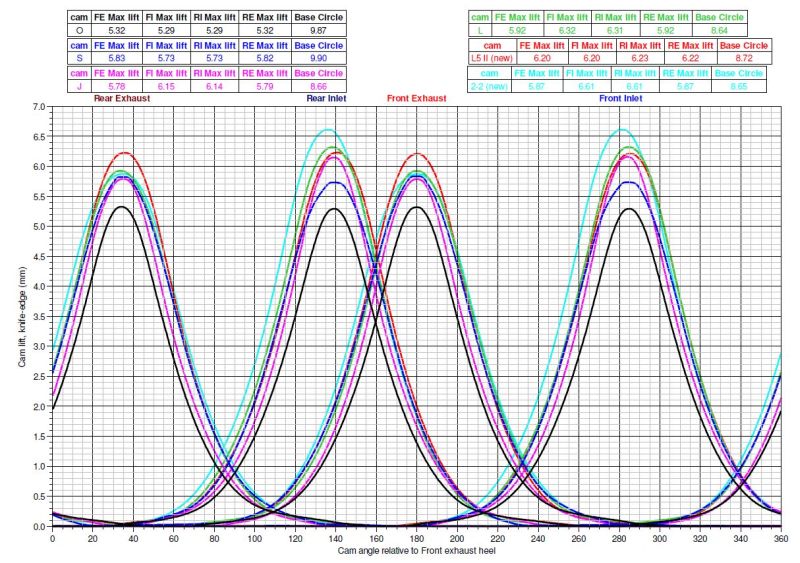

Paul Compton and I undertook a pretty extensive bit of research, sourcing as many original cams as we could, many of them brand new, and me measuring them at work in our protoype engine metrology lab. We now have sufficient profile data to be able to commission cam grinds to the origial specification. If anybody wants a cam then the preferred route is to provide us a donor cam, and we can get it reprofiled with one of the other profiles. You wuold likely end up with a smaller base circle than original, but the lift curve would be corrected for that.
I can't share the measurement data but below is a plot of the main cam profiles (this is knife edge lift at the cam, not valve lift). You can easily see the differences between cams. The two 'L' profiles (red and green) have very similar inlet profiles, but the so-called 'L5' has greater exhaust lift. 2-2 has a similar exhaust lift to 'L' but the greatest inlet lift of all.
Perhaps the most surprising observation was that the 'J' cam (excalibur etc) looks like it's somewhere between a sport and an L. I'm surprised more people don't run J cams. Perhaps they get tossed aside as 'just cruiser cams', but it's be interesting to see how a good sport runs with a change to a J cam.
We also measured some cams from the pre lambertini singles, and it was very very interesting to find that the profile of a 2-2 cam is as close to identical to the setebello as you will ever see. (which doesn't necessarily mean anything, as you would need to do some calcs around the follower and rocker gemoetry to understand what that means in valve motion)
Paul and I are keen to do another batch, so if anyone likes the look of any of these, then drop us a message
Interesting weekend reading for you in any case!
