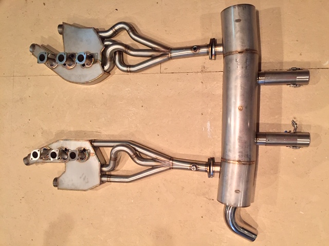

A good welder who is familiar with stainless steel could make your pipes fit correctly. They will have the correct welding rod for stainless. It’s true that stainless will soften and move a bit when hot but that won’t fix a part that wasn’t made correctly.
I’m pretty lucky to have a friend who’s a pro welder and can weld stainless, aluminum, magnesium and titanium.
- Custom SS heat exchangers and muffler
- C16B8637-F598-4183-A940-71FEBA109F2A.jpeg (106.54 KiB) Viewed 9487 times
