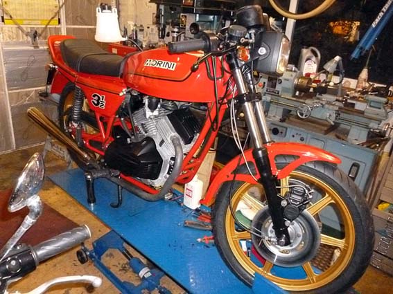

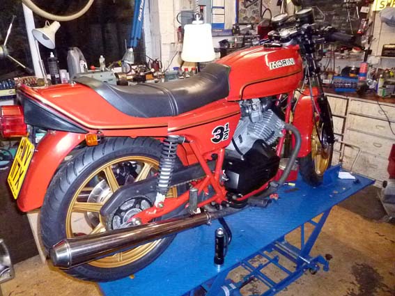

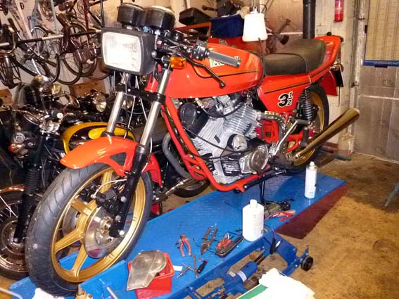

I thought I'd update you on progress so far. She's looking a lot smarter than she did when I got her after her decade-long slumber in a boat shed. I've gradually worked my way from front to back cleaning/polishing and making stainless steel bits and pieces. Sorting the electrics alone was a 3 day job. Only the horn button claimed a short lived victory by refusing to allow enough current through to operate the horn - it would however trip a 30 amp relay so had to give in eventually. Working my way through the wiring system (with the help of an excellent colour diagram from the MRC site) it dawned on me why the Italians never adopted the electric chair as a means of execution. They'd need to employ a full-time plug-kicker :roll:
There are a few more jobs to sort - new rear calliper pistons are proving elusive though Rob at NLM tells me they are hoping to have a supply soon. If not I'll have to set to with the lathe myself. I've also ordered a set of stainless down pipes to match the silencers - again, Rob hopes to have these before the 21st. If all goes well I may have a complete black system to sell at some point in the future.
Painting jobs still on the list include the nearside engine casing and the rear springs. I'm going to mirror polish the clutch cover to see how it looks. If it's too garish then the satin black tin will be opened up again. Apart from tidying up the instrument bezels, that'll be about it for the time being.
Mrs GB is itching to have a go on the bike but there'll be little chance of that until the winter's over. It'd be a shame to get her (the bike!) wet and salty after all this :wink:
Steve

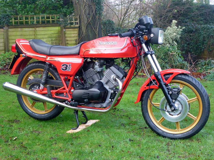

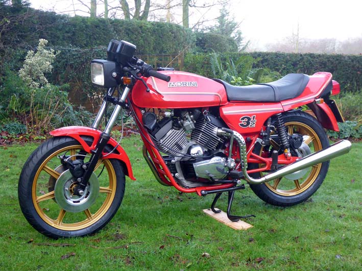

Almost there - call it Mrs GB's Chrissy Prezzie. She got the matching sweatshirt yesterday :D
I ended up making a pair of stainless rear caliper pistons. I bought a length of 1 1/2 inch bar (38.1mm) which needed just a thin skim off it to bring it down to a mite under 38mm for a good fit. I did try some Suzuki 600 pistons that were advertised as stainless 38mm. When they arrived they were chrome plated mild steel and 38.17mm so wouldn't fit. The chrome prevented any attempt at skimming them too. A length of bar was only 20 quid and I've enough to make another couple of pairs I reckon, though I doubt if this bike will ever be needing another set :wink:
Just a few minor tweaks to do yet - I don't like the run of the front brake pipes for a start - mainly cosmetic bits, but I still need to change the fork oil if only for my own peace of mind. I'm still considering whether to treat the inside of the tank with sealer. It's actually in superb condition inside but I'm in the process of sorting a Honda tank out for someone so it'd be a convenient time to do the two tanks.
The local Council were out and about slinging salt around on Chrissy Eve so there's no chance it's going to see tarmac any time soon.
Steve
