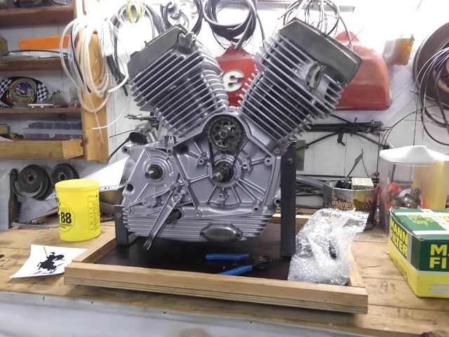

I´ve made an engine stand using a strong plate of plywood and two pieces of steel in form of a U. It´s very easy!
This model can be covered with a box of thiner plywood. I´ve made it because I had to sent this motor to Madrid and back again when building up Dulcinea. It works very fine for the transport of an engine, the box is still ready for use and the base works as an engine stand.(I´ve been a carpenter in former times

Nice crate Norbert.
How do you find the lightened cam pinion? I’ve heard some say they’ve had running issues with that lightened (inertia of the pulley helps stabilise the speed of the pickup trigger perhaps?)
And I can see from the neat welds you’re another convert to the roller main bearing!

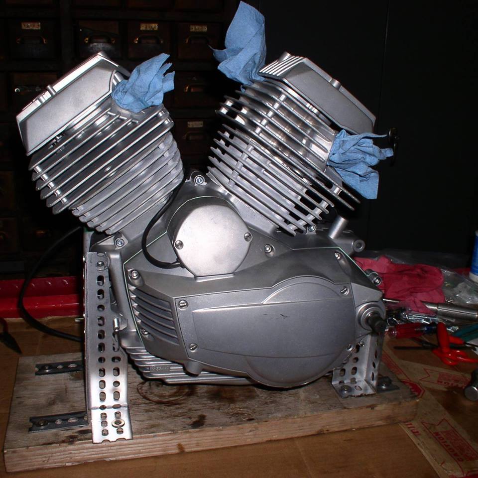

Charles made one for my engine. It should get a lot of use with 2 more bikes to finish.
