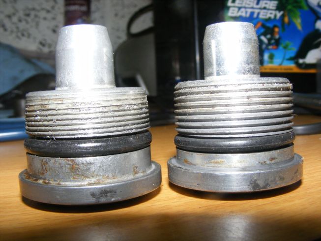

Hi Steve,
Hopefully the attached will help?
If you can't see it, pm me with your email and I'll send my fork notes/pics to you.
Regards,
George.
Regards,
George.
- 2 old and new fork cap nuts.jpg (68.15 KiB) Viewed 9852 times

Re: forked
thanks for that i guess the one one the left fitted the tarozzi any pt no?

Re: forked
Sorry Steve, no different numbers. Was the box of s/h nut and a sort through.
But. An interweb search brings up www.classicducati.com . Do a search for item SS21and all will be revealed! Do lots of little items of interest to Morini owners.
Regards, George.

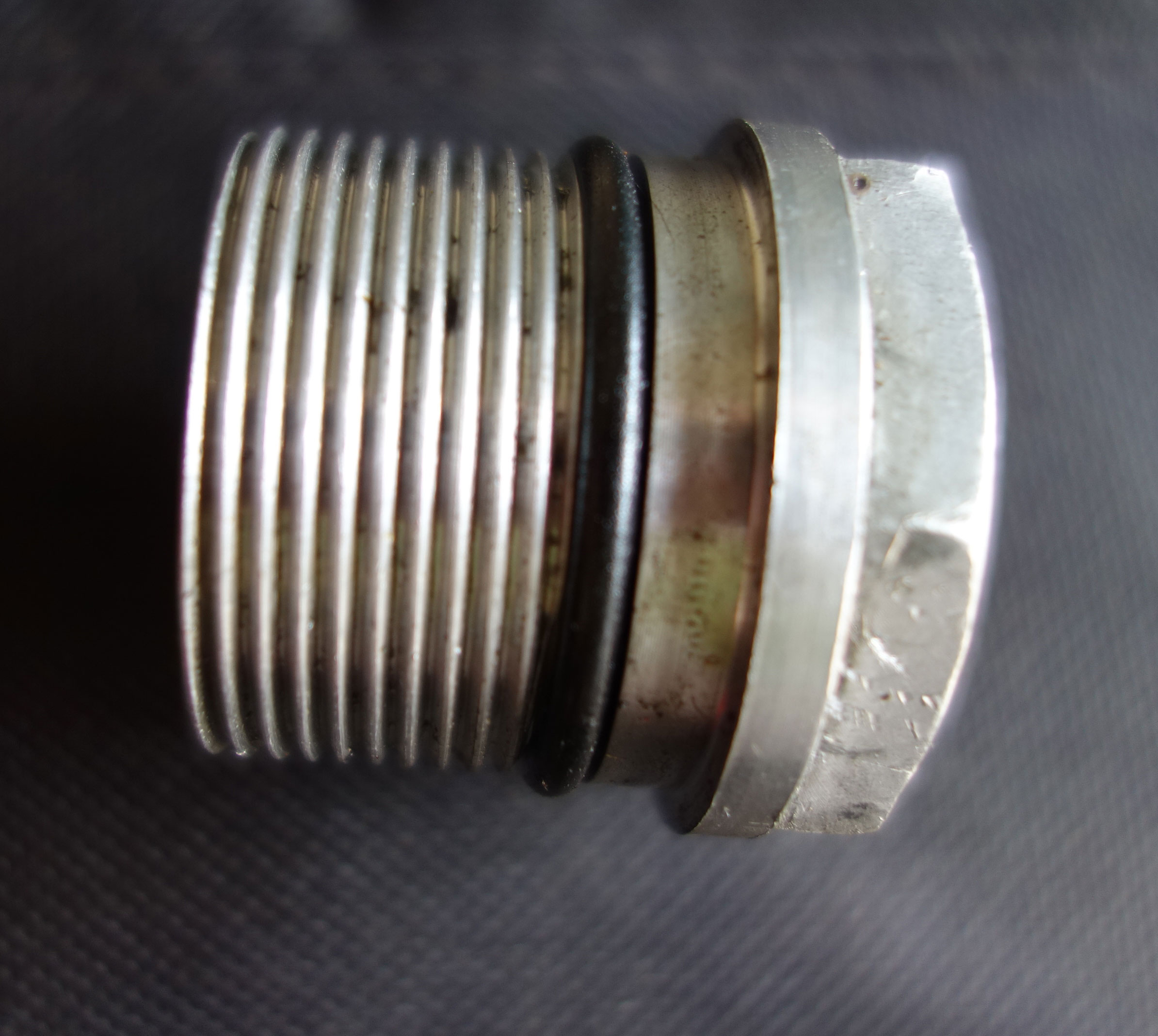

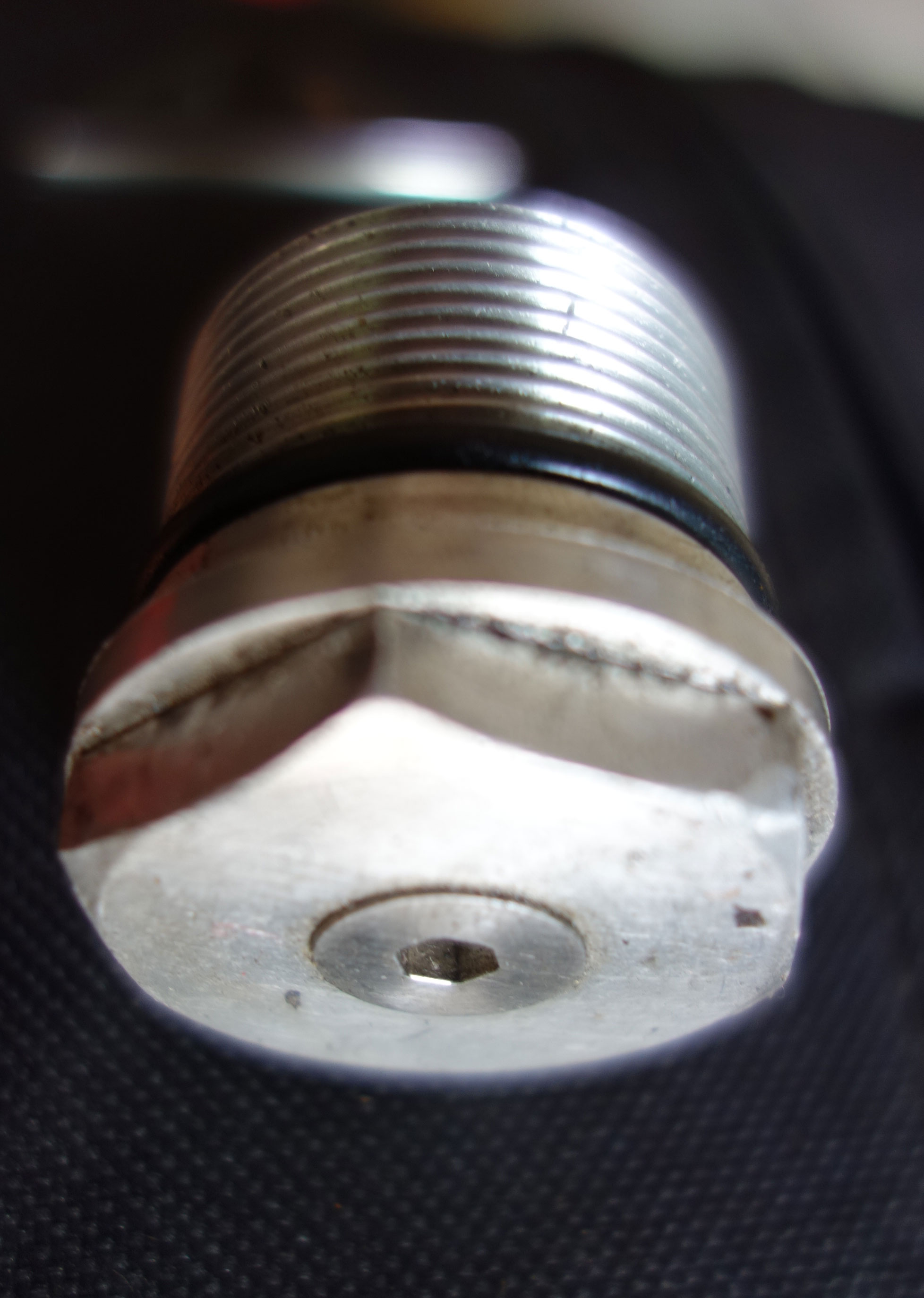

Re: forked
george
youve showed me yours heres mine: 81 sport
- fcap3.jpg (321.58 KiB) Viewed 9793 times
- fcap2.jpg (346.36 KiB) Viewed 9793 times
- fcap1.jpg (424.37 KiB) Viewed 9793 times

Re: forked
hmm slight scale problem!

george
looked at the duke site so do you think that their one mill cap is the same as your left pic?

Re: forked
I'm pretty sure it is. Going back to your original question regarding thread pitch, If you don't have a thread gauge, then get yourself a standard 6mm and 8mm bolt. Place each bolt in turn into the threads in the top of your fork tubes and only one will accurately mesh into the threads.
If it is the 6mm, then the classic ducati ones are what you need (1mm pitch). If it is the 8mm then you have a problem and will need something else (1.25mm pitch)
I've only ever seen them in 1 or 1.5mm pitch though, and my Tarozzi stanchions are 1mm.
Regards, George.
Regards, George.

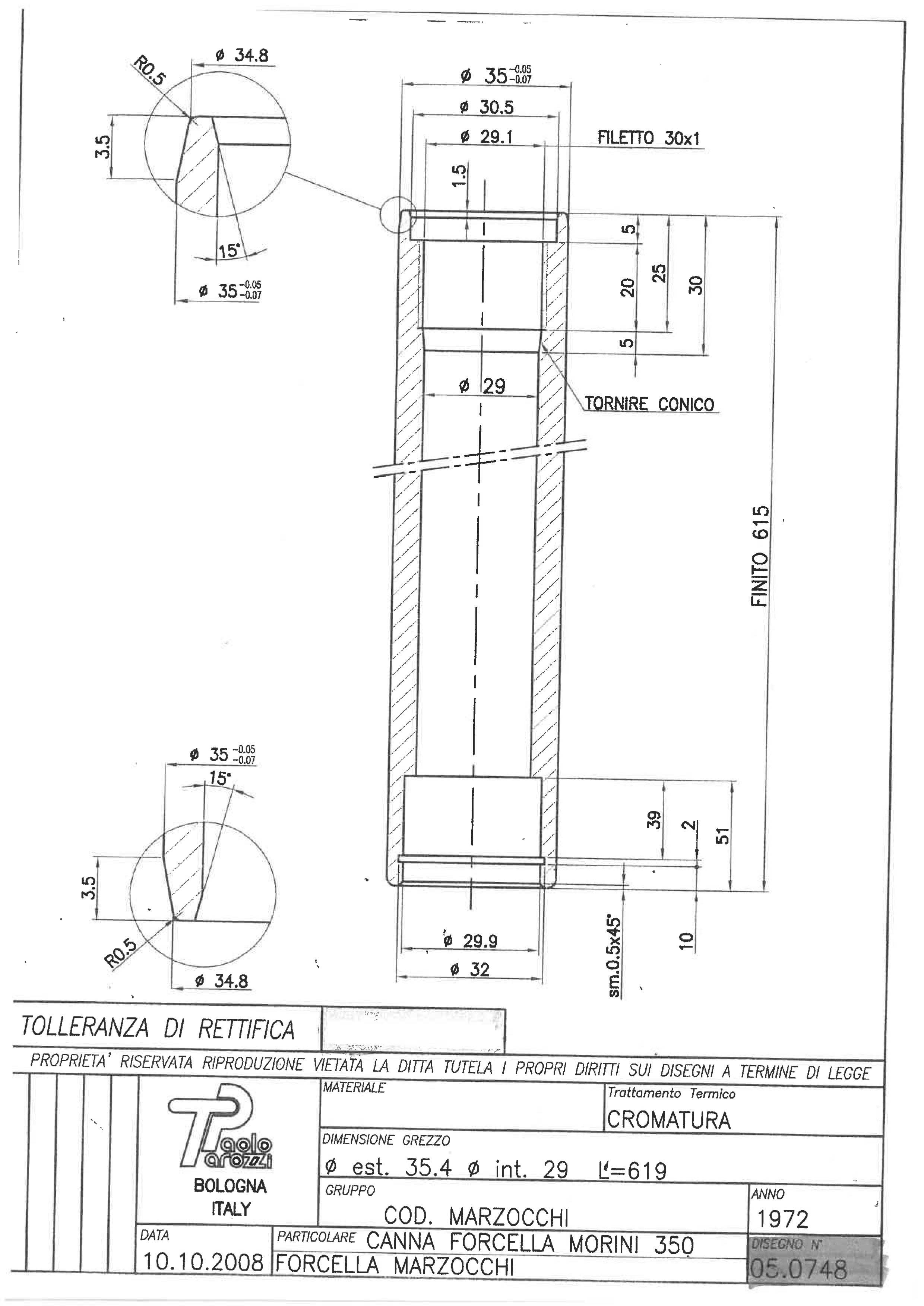

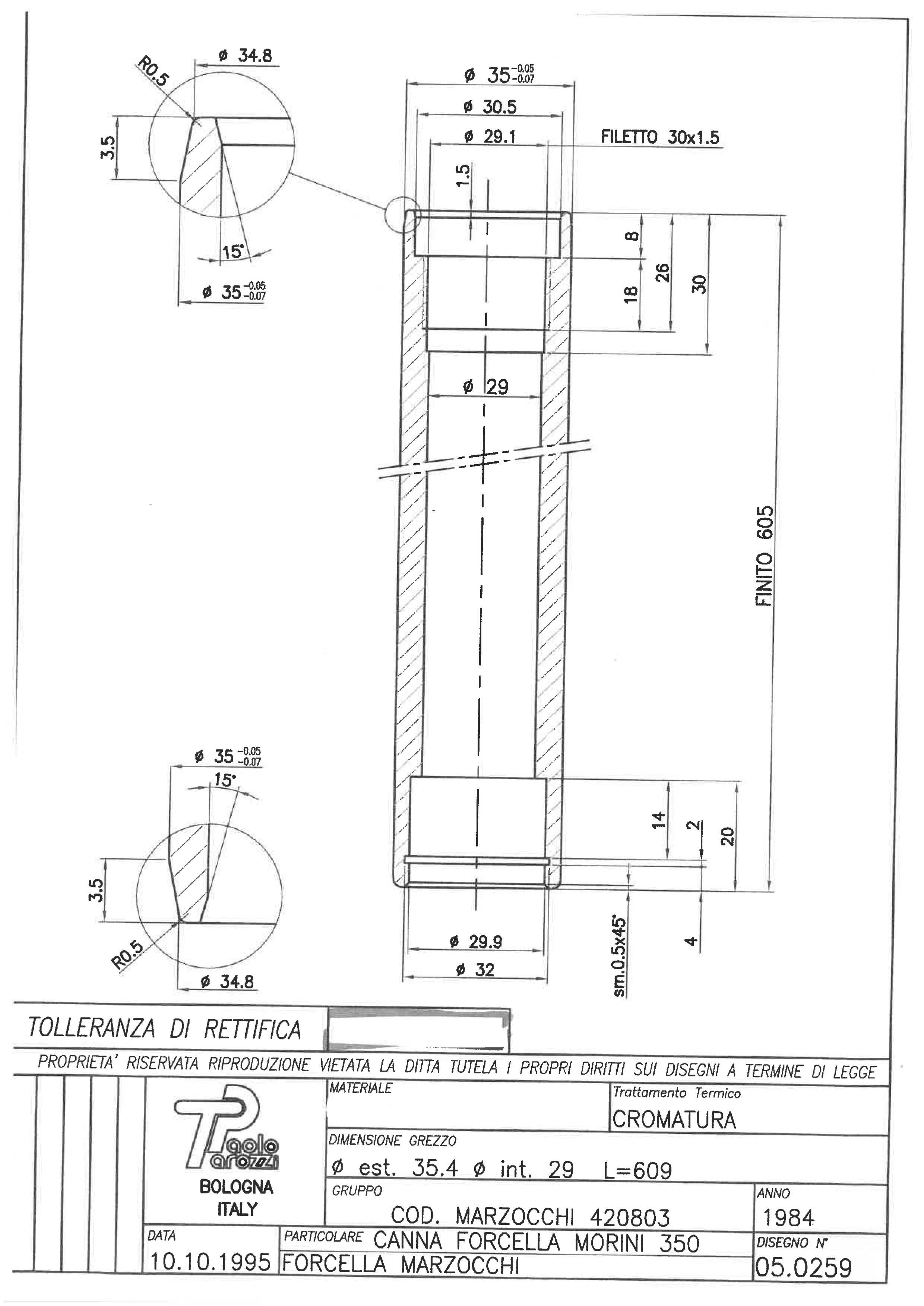

Re: forked
got the fork caps and they fit but tarozzi (via wemoto) say that i probably have k series forks! so now i have composite forks is this a problem?
tarozzi sent drawings which maybe of interest but ill have to convert them from pdf as apparently you cant post them!
scbond2@yahoo.co.uk
- Posts: 76
- Joined: 03 Aug 2018 23:18
- Location: kent uk
Re: forked
tarozzi drawings
