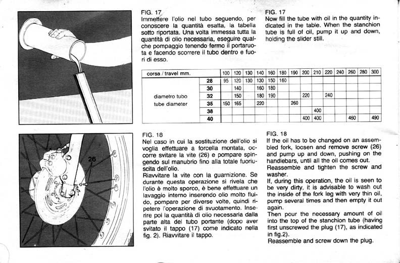

I have a K2 Sport, and an owners' manual. The manual does not even mention forks or fork oil. I have used ATF in all my bikes' forks over the last 40 years with no problems. I think it's around SAE10. I take this page from an old Marzocchi manual as reference for volume.

Ming Thank you for the table of oil volumes to be used, very handy. :D
