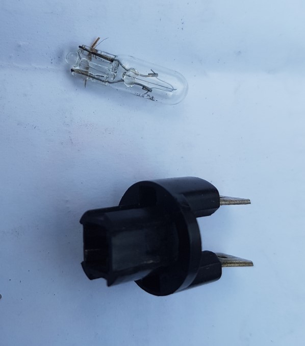

Has anyone located a source of the small wedge bulb (T5/286) as used on 1977 on 350/500 sports/stradas and 250s with the rectangular warning lights.
The morini part number was 46.03.25 - not coming up on Mdina Italia.
Most T5 holders I can find are the twist in type used on car instruments panels.
I can't find any push in ones with 6.3mm spade terminals.

Thanks guys - I have the bulbs they are 286 bulbs- but i will check out the LED replacements that Ming put me onto.
I am trying to get the holders are in the picture:
Warning light holder
The critical diameter is about 9.5mm, that which fits inside the instrument light lens (red,blue, green etc)

For the holders, you could try Moto Guzzi bits. If you can't find any and are handy with a soldering iron you could make up some bespoke lamps using individual LEDs with appropriate series resistors to fit in the lens units. You could even use coloured LEDs and limit the current to dim them somewhat.

Gutsibits have the larger sizes, I also checked the BMW R series and they use the same bulb but have a rectangular fitting.
All the car ones are twist fit into a thin panel.
I think I will try to adapt the LED ones you found on Amazon - they so cheap its worth a punt. And you suggest limit the current.

Thanks for looking - these are for BA9s bayonet bulbs - actually they are used in the speedo/tacho on post 1979 models. so its a useful source.
They are too large for the warning lights though.
Bill,
Link: eBay_T5_286_wedge_bulb_sockets
These look promising - I'd have to file off the lumps, these are normally fitted into panels with a 90 degree twist.
It then depends if I can get the right push fit.
