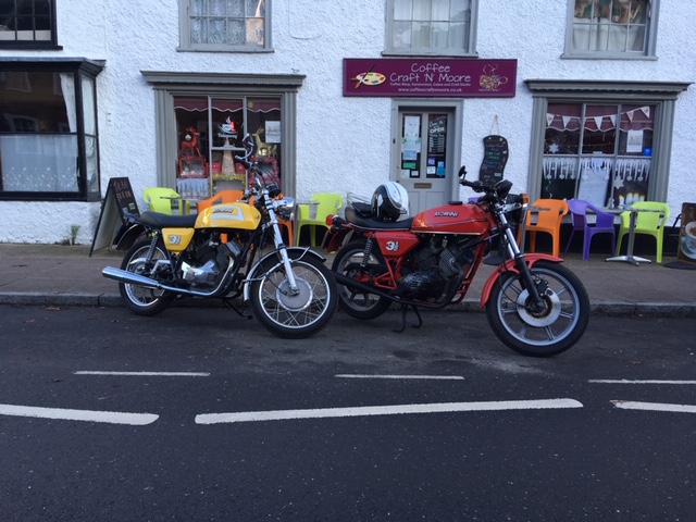

e
Mines the red one.
Mines the red one.

Nice picture, thanks for sharing. So glad the noise was something easy to fix!
If the insulation under the tank is the correct thickness then the line of the seat trim and the line of the tank pin stripes is smooth and continuous just like yours is, which makes it more aesthetically pleasing.
