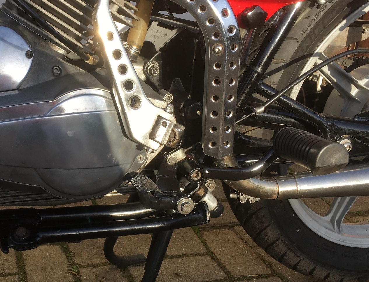

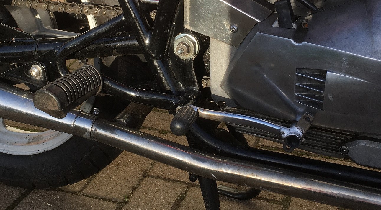

So , I offered the left one up to the bike in a reversed position , wow , that’s exactly where I need , slowly depressed the kickstart and it cleared ! no rubber on , fitted the rubber and it just touched .
Removing the rubber I cut 15mm of the footrest and assisted the rubber back on with a mallet , well clear !
It is tight against the armour front pipe , I think just touching is a fairer description rather than tight , easy to sort with a little easing in the vice.
Hopes up, I looked to the gear change side and that footrest , reversed , was perfect .
I removed the linkage and the gear-lever , the gearchange clamp and gear lever Are same dia so I tacked welded the lever to the outside edge of the clamp and tried it , touch too long for my size 11 , so , removed the rubber and cut the end off , shortened the lever by 20mm and rewelded it .
It may be that a strada lever may fit without welding ?
Committed now , I needed to sort the rear brake lever
Do I make a complete new arrangement ? Or shorten the existing ?
I decided to shorten the lever drastically.
Background to this decision, my rear brake has always been very good , in fact too good and would lock easily and it took a conscious effort in an emergency To resist stamping too hard especially at low speeds .
I shortened the lever by 10cm I made the cut near the pivot at an angle so the lever would come out at an angle , welded up and tweaked the footpad out a touch with Stilsons .
Out to test . My bike ( like many) was a pig to engage neutral and my 2nd to 3rd change up needed to be slow and deliberate . So far gear-changing is much more positive and neutral is my new found friend ! The pattern is reversed and this may help with actual changing
Rear brake position is good and braking is still strong , it takes more effort but feels far better , as it was ,it felt like a hydraulic brake and panic stomps caused lockup’s , now it can still lock but has far more feel up to that point.
I still need to test the rear brake at sunny early morning speeds but in town and country roads it’s a big improvement despite its lack of leverage .

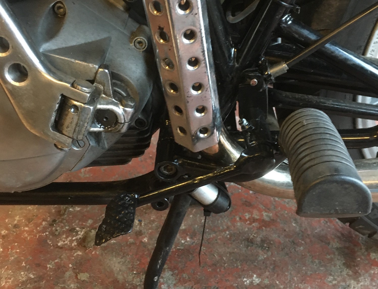

Although adequate in the town , when ridden as it should be the amount of force required to use the rear brake when multiple bends are encountered causes the body to tense and spoils the flow , so, reluctantly I had to rethink the rear brake arrangement
I welded a boss on the top of footrest hanger towards the rubber and made a new lever incorporating the original foot pedal .
Space is tight but whole thing comes off with the footrest with one bolt . same pivot and cable just shortened the inner
Now the leverage is almost the same as original , just a touch less mechanical advantage which works out well.

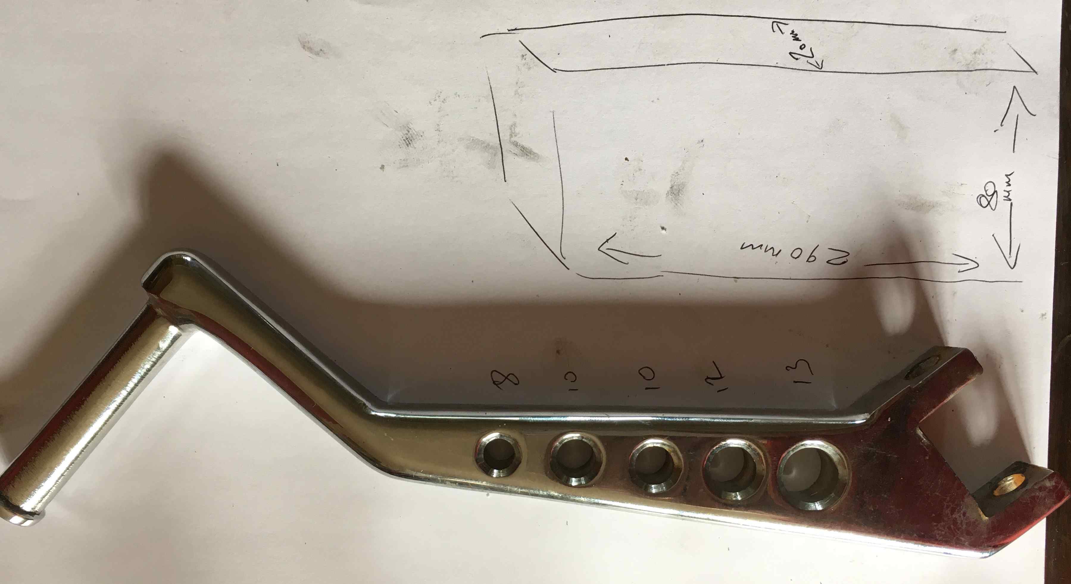

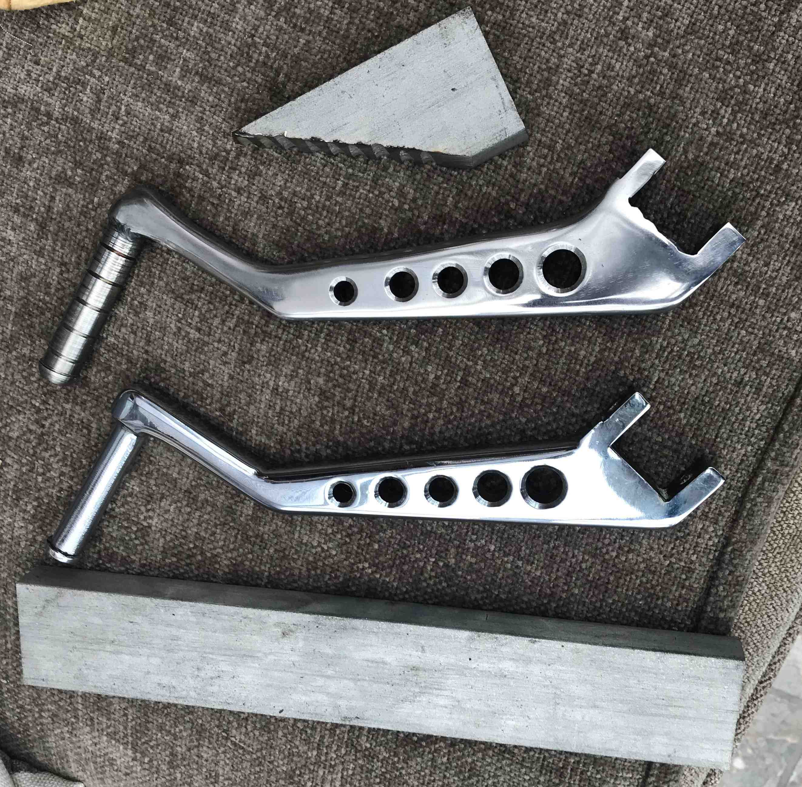

Ahh.. My kickstart isn’t NLM , I was looking after a 500 that was for sale here and that had a good looking kickstart fitted, i presume that is an NLM one?
I liked the look, so made one like it , I think the one on the 500 was brass that was chrome plated ? It could just have been
Heavily plated with copper I didn’t want to scratch to find out .
Anyway mine was a lump of stainless steel I chain drilled out roughly then hacksawed and filed to shape , the hardest bit ( pun intended) was the holes ,it took longer to put them in than cut and file to shape , the stainless, work hardened at every opportunity .
It is heavy .
making pictures small enough to upload is a challenge , any suggestions very welcome.
I will refit the original alloy one and see how it fits

Hi. I cut mine from 30mm thick HE30 aluminium sheet. A lot easier to cut and file than stainless steel! . Works as well as yours does too. The original shown proved 100% reliable until it and the knuckle assy it fixes to disappeared while on a motorway in Spain. As a result I had to make a 2nd one.
Re: Rearsets
Lovely , very neat. Yes the original ( I think) ally kickstart hits the rubber, 25mm off would probably see it pass and still be enough of a perch .
