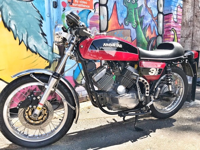

Regarding brakes, my 350 has a floating disk, Brembo caliper and m/cylinder and it stops really well! It’s also got switchgear from a Suzuki GT380 which is a useful fit as it has all the Switches for lights, indicators and horn in the one unit. Switchgear from some fire blades also can be used, but is a plastic housing rather than metal as on the Suzuki
http://www.norbsa02.freeuk.com/goffyWhyNotLEDs.htm
