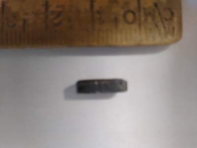

Building a 350 engine (I bought a bottom end and am putting my top end on) I drained the oil (I was informed there was no oil in the sump) 2.5 lires fell out. Undid the oil filter housing, drained that and then had a look. What is that piece of metal? Out with the magnet and hey presto a woodruff key!

The only thing I can think of that is key like is a gear tooth. I've had one break off of a cog many years ago.

I did think of that, but it is too regular. I'll have a look with my mirror.

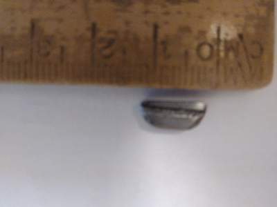

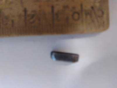

Not good pictures. The item has been squeezed as is indented on both sides..

A simple check as to whether it is a gear tooth or a woodruff key is to run a file over it. Woodruff keys are normally soft and can be filed, whereas a gear tooth will be rather hard.
If it is a woodruff key, it could have got there when a former owner was refitting the cam with the keys still in it - it could have caught on the bearing and 'pinged ' inside?

So, I went out to the garage and got out the old Bastard. The piece of metal filed easily so can safely say it is not a gear tooth. The oil pump turns, the camshaft turns when I turn the crankshaft. I'll check the keyways on both, just in case. Thanks for the advice.

Maybe one fell out of the crank or camshaft backalong and if the filter was already removed dropped into the crankcase, then a previous owner spent ages looking on the garage floor for it.
Let’s hope the ones that should be fitted are all there.
