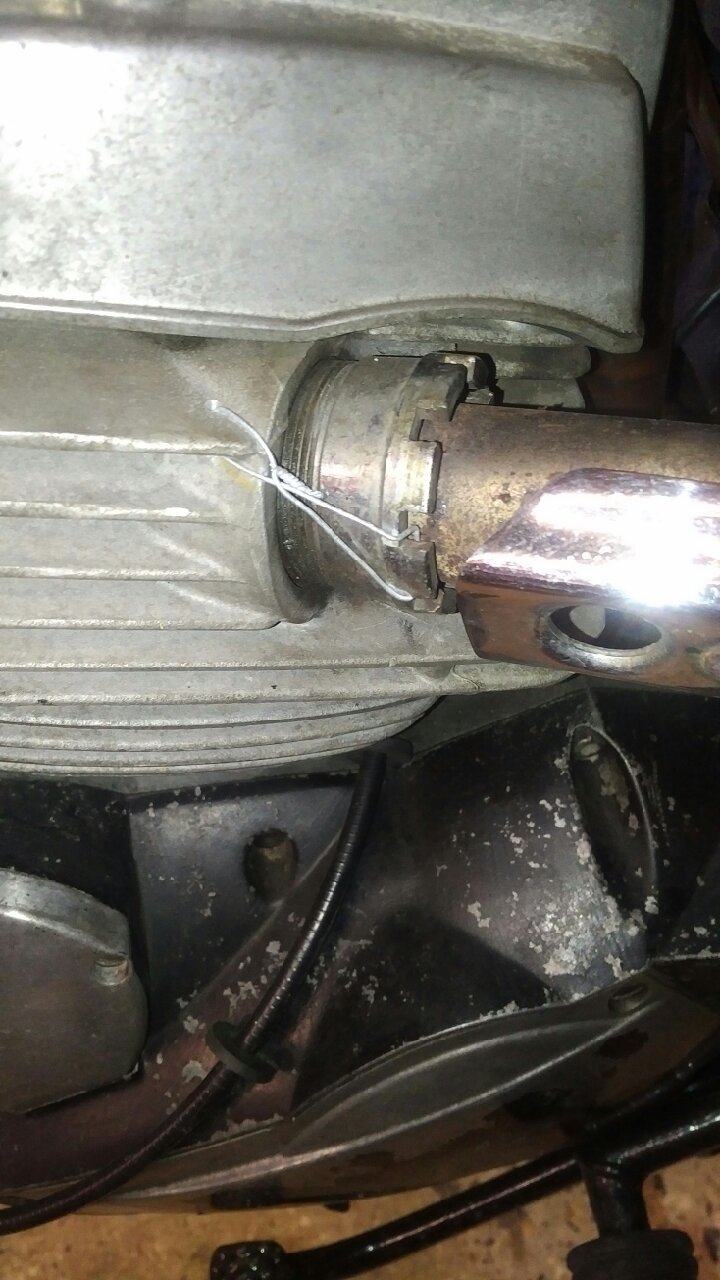

As I was riding home from the Corsaro section gathering in Alton last weekend my 350 sport became very loud as I rode up the A3. I was just a mile from home so rode back.
Once home the reason for the noise was obvious, as the castle nut on the front exhaust was sitting on the down pipe near my toes. This was wired when I bought the bike though the other wasn't, I had been regularly checking the other but assumed that all would be well on the wired side. Clearly not as the wire had slid down the pipe too!
Nut is chewed up but I can get it tightened easily, so I assume the threads are fine. I just need to know what I have lost and where to buy replacements as the pipe is very loose now with the castle nut tightened and certainly is not making any seal there either.
Any advice welcomed.
Mike
Mike

Probably the two half collets that holds the nut on the pipe. Do you still have the gasket?
Mike.
Mike.
- Posts: 1651
Re: What have I lost?
As Mike says, the half collets. Trouble is they come in about 3 or 4 variations! The shape and dimensions of the flange on the end of the pipe determine which you'll need. If you can post a pic (I never can) or a drawing with dimensions of the pipe it will make things easier.

Thanks Steve I’ll have go at measuring tomorrow.Steve Brown wrote:As Mike says, the half collets. Trouble is they come in about 3 or 4 variations! The shape and dimensions of the flange on the end of the pipe determine which you'll need. If you can post a pic (I never can) or a drawing with dimensions of the pipe it will make things easier.
I may even have some to suit!
Mike

Right, the flange on the end, how thick is it? Some pipes are thin there, just the pipe itself flared out. Others are around 3mm thick, a collar welded I think to the pipe.
If you can get the thickness of that flange it will help.

With many thanks to George 350 I now have the collets and a fully functioning front exhaust! I now need help to source a pair of half rings that fit the "square" section flange to replace the ones George sent to me today. Any leads on finding replacements welcomed.

Lockwire the castle nut to a fin on the head. Resist the temptation to heavily tighten the nut, there are stacks of stripped and seized examples out there that are due to overtightening.

When re-assembling, apply liberal amounts of copper grease to the components before tightening with a correct diameter 'C' spanner and then lockwiring as suggested by 'BumbleBee'. It should make future dismantling easier and component corrosion or stripped exhaust port threads less likely.

You should lock it with the wire after doing some rides and repeating to turn the nuts as much that you can with a hot motor!

All good points already made.
to add
1. Never use the nut to haul badly fitting pipes into the head, sort out the fitting first! The rear footrest/silencer hangars are often bent inwards.
2. Don't use any exhaust sealant on the thread.
3. Remove any hardened deposits from the threads before reassembling. I use a right angled scribe.
4. Make sure the silencers are properly supported - two bolts and a proper bracket at the rear.
5. Tighten each part of the system a little at a time, to find the best position.
to add
