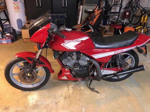

Hello all, my name is Owen Lloyd and I live in Virginia Beach, VA. I recently moved here from California (Navy) and have restored a few BMWs, Moto Guzzis, Hondas (CT90s), and a Sears Allstate (Puch) 250. However a big thing happened to me the other week... I have always wanted a Moto Morini and got my hands on a fairly descent 1984 K2. It will need a medium amount of work to get to the level it deserves to get back on the road but all in all I think it will be a fun "restoration."
My plan is to paint, de rust, and powder coat things that are in need but otherwise leave the bodywork as it came off the line in January 1984. I figure original paint is only original once, but one can make the other bits more cosmetically appealing and bring up the bike overall.
I will need a lot of help a long the way and already have a multitude of questions, but I figure I will meter them out as I get to the relevant portion of the refresh. Attached are some photos.

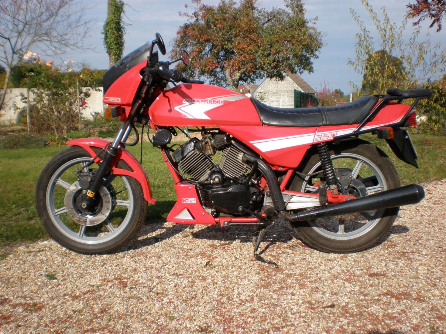

Hello Owen, I too have a K2 in a similar condition. Doubt I can help much spares wise, though I do have an airbox in useable condition, I imagine delivery would be expensive. I'll check for a gear lever too. I have a fair bit of information up in the cloud which I can give you access to if you PM me your email address.
Seeing your Avatar - I also have an old R1100R. Here's the K2

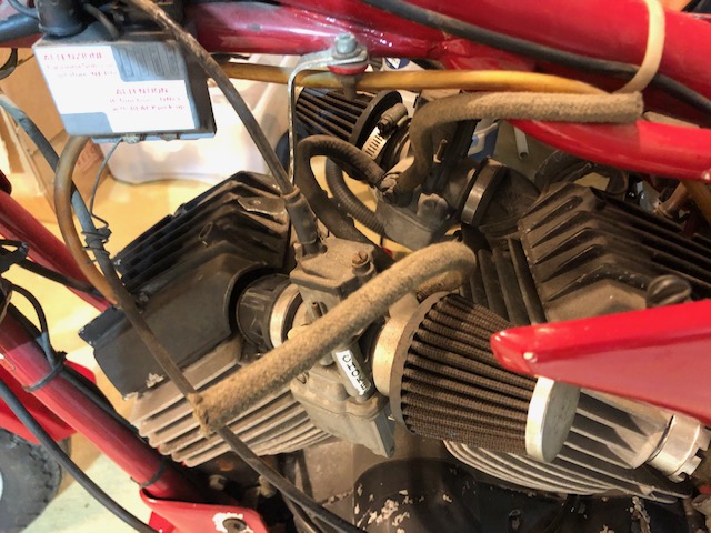

Themoudie, thanks for the tips! That does sound like a lot of work with the air box. My goal after lurking on this forum for a while was to get rid of the K&Ns because other members posted they had issues with jetting and supporting the carb elbow to the head. I am trying to avoid fooling around with jetting as it is not a strong point of mine, but I’m open to recommendations. Is there a super thread with pod filter Q&As with definitive recommendations for jetting? Also isn’t there an issue with one of the carbs being exposed to the airblast thus affecting running?

if the filterhousing of the K2 is the same as the other Tremezzo (I guess it is so), I can offer you a used one for a reasonable price. The rubber elbows are offerd here in germany for 60€ a pair (plus porto inside the country). If you are interested, I could order the elbows for you so it would be only one package from Gremany to the States (no idea of shipping costs :roll: ). I´m going on holidays in about 10 days and will be back 10th of august. So if you are not in a hurry things could be arranged in august. I´m not sure if I can also order the filters itselfs (I only have the housing, probably with very old filters inside), but I can phone up my dealer and ask him.
Using pot filters you should make yourself some brackets to hang the carbs. Some people have problems with pot filters with the rear carb because it´s facing directly into the wind. Others use them since years without complaining ... :roll:

R1100purist wrote:T...My goal after lurking on this forum for a while was to get rid of the K&Ns because other members posted they had issues with jetting and supporting the carb elbow to the head. ...
I know what you mean. My K2 has pod filters too, which I intended to change back to original having read so many posts on their problems. However, mine starts and runs 'on the button' and feels to have plenty of power all the way up. As I don't use it a great deal I have not got any further with it on the If It Aint Broke principle. It's a job you can always do when the bike is back up and running, though it does mean tank removal and some wriggling about.

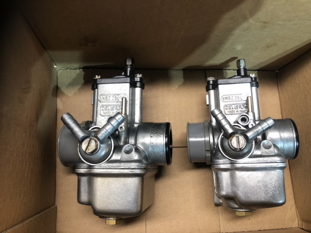

So update from me. Started slowly taking things apart for cleaning and refurb starting with the carbs: after an order from Euro carb here is what I have:
I used my ultrasonic cleaner and aviation simple green so get them clean an degunked. I think they were not run in 30 years, so they were pretty nasty!!
