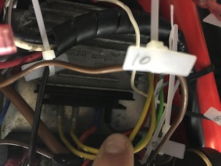

The regulator has the 2 yellows from the alternator, brown to the switched positive side of the fusebox and then an additional red which is not shown on the wiring diagram to the hot side of the fusebox.
Regulator is a Ducati energia 343152

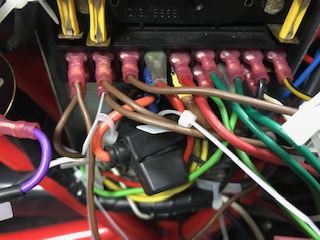

Probably pointless trying to provide photos of the wiring but I've unplugged all the top connections to give a better view of the bottom & regulator.

Good result. At least you can get to the fuse box easily enough.I have put some 3M adhesive film on the inside of the side panel as a hedge against cables rubbing bare metal. In your photo I was amazed as to how clean the wiring looked, mine is usually covered in what a publican once referred to as “road dirt” just before he threw us out. I have removed and tidied wiring from my K, especially from the rear as there seemed to be an over provision. Dirty connectors or corrosion within the wire ends are a worry. You cannot beat getting the correct coloured wiring from vehicle wiring products when you need any.
