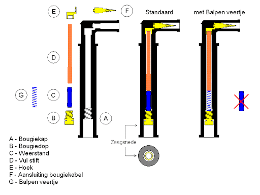

you can even make 'm 0 kOhm like factory spec by screwing out the resistor and replacing it by a ballpoint spring
(or brass rod)
(sorry, picture in Dutch but you'll figure it out)

Tried unscrewing NGK SB05F caps and failed. They seem to be glued together so bought the SD01F instead.
Re: Morini novice
Thanks, will take a look at my oldest caps to see if I can take it aparthendre wrote:you can even make 'm 0 kOhm like factory spec by screwing out the resistor and replacing it by a ballpoint spring(or brass rod)
