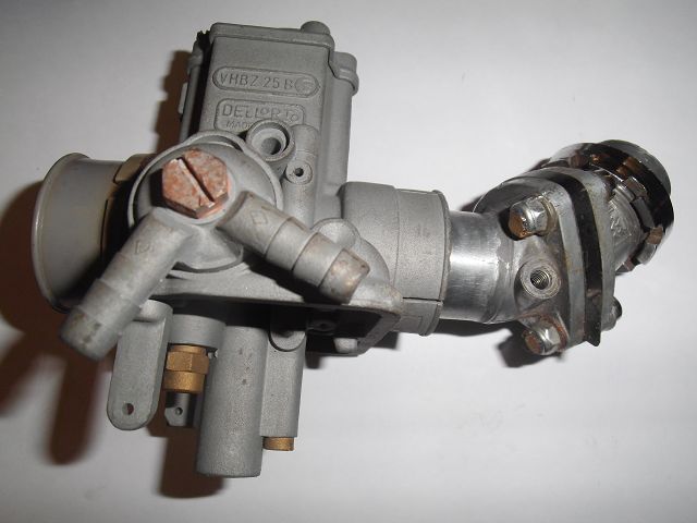

Re: Three years later, still having problems with idle
I agree to what Harry and Mark said.
I don´t know what GT85 is, but too seek false air you should use brake cleaner and not WD40.
I would try the VHBZ from that Kanguro after getting them setup with the jets required for the Strada air filter. But you need a VHBZ 25 HS!
I´ve examinated lately the VHBZ 25 and VHBH 28 a bit more serious and found out astonishing things (mainly with the VHBH 28, I´ve got for examle three diferent housungs all named VHBH 28
) There is an article about that in the last La Strega
Just a little resume of the VHBZ 25, if you like:
There are two, the BS and the HS. One of the two main differences is that the BS is for the old metal intake manifolds and therefore slotet on the side towards these manifolds carburater/head. You can use them with the rubber manifolds but then need the black plastic reducing tubes on this side fitted in the HS version (right hand BS of the foto). Meanwhile you cannot use the HS with the metal maifolds. The second main difference ist that the HS have the brass coloured vacuum tubes (for using balance clocks, depression fuel taps, scott oiliers etc.) This ports mut be connected with a tube or closed carefully. And the HS have two little brass tubes for ventilacion of the float chamber. They are useful on enduro and cross bikes because these ones are more often lying on the side and will not loose petrol that easy if there are tubes on them reaching up under the tank. Forget about the ventilacion tube on the outer side (with the screws for mixture and slide height) This ones are fake drillings, not reaching to the chamber.
The BS ventilacion drillings are semiclosed with a metal seal that allows breathing (like the older VHB 25 and the older VHBH 28). With the VHBZ BS it is the other way arround: Here the inner ventilacion drillings are not reaching to the float chamber, so ventilacion works on the outside. And there a very little drillings as well in the ventilacion chimneys close to that metal seals. This drillings are open as well, meanwhile they are closed on the HS version.
Since I´ve discovered that, Im quite sure that the famous carburator problems with strong side wind is happening probably only with the BS edition. Can anybody confirm this?
The fotos show the two sides of the VHBZ BS above and the VHBZ HS below: (the metal seal of the left hand BS was taken off to replace it by a little corner tube that some of the enduro riders will know, the forerunner of the later brass tubes with the HS)
BS with the metal manifold last not least: the BS dont´t show a production year, the HS do. But you have to remove the floats to see the year. My VHBZ 25 HS housings with dismantled floats are from 1985.

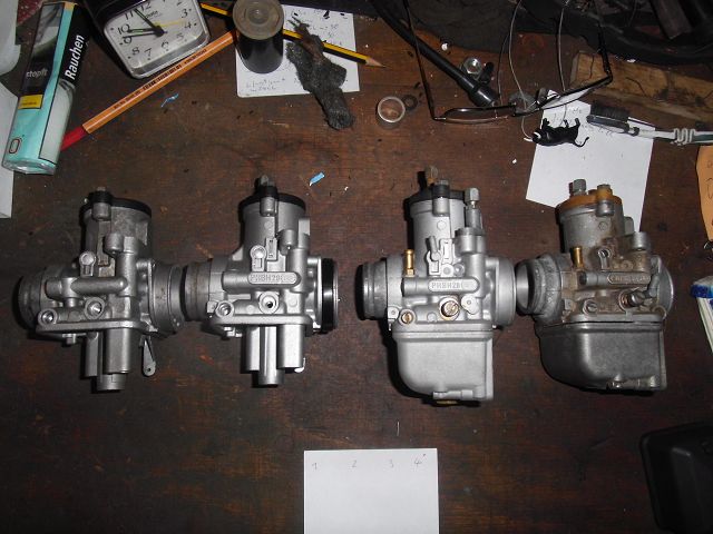

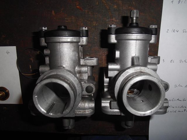

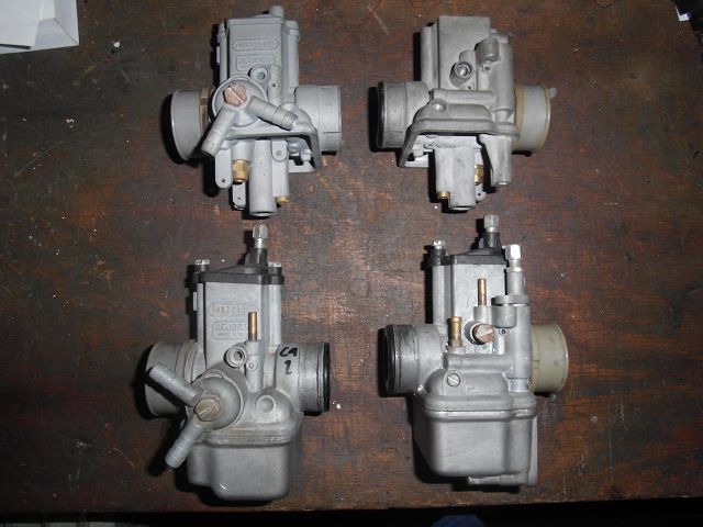

Hi John that with the oval hole dosn´t sound very good. I guess you are talking about the little mixture screw. Are you sure that you dismantled and put back the tiny washer and O-ring on both carbs?
I think you are talking about the PHBH 28 BS originally for the 501 motors. Which model do you have? I´ve got three diferent housings, all named BHBH 28 BS (1-4 from the left side, 4 is only a variation of 3 with a corner tube to ventilate the choke system)
The most interesting diference is between 1 and all the others (newer ones): The idle mixture sistem is totaly diferent. You can see from the outside that the chanel (where the modern ones have written PHBH 28 BS. The older ones have written this on the otherside )is going a very diferent way, ending up at the head-side like this:
the old one on the left . The idle sitem end in two rabbets, meanwhile the newer ones are ending like we know that from the VHB carbs on the right hand at about 5 o clock
I discovered this a few month ago when trying to adjust my carbs. And noticed that I have an old and a newer one each on Dulcinea and Rocinante. They work both more or less fine, but maybe this is an explicacion for strange and diferent behavier using chokes to start them (one of the old ones is on the front and on the other bike on the rear cilinder and it´s a bit dificult to reach the rear choke at Dulcinea because of the big aluminium tank). There are still some miracles appearing with that old fantastic bikes
I wonder wether this change of the idle sistem was an imrovement or just dued to lower production costs
ciao
ciao
