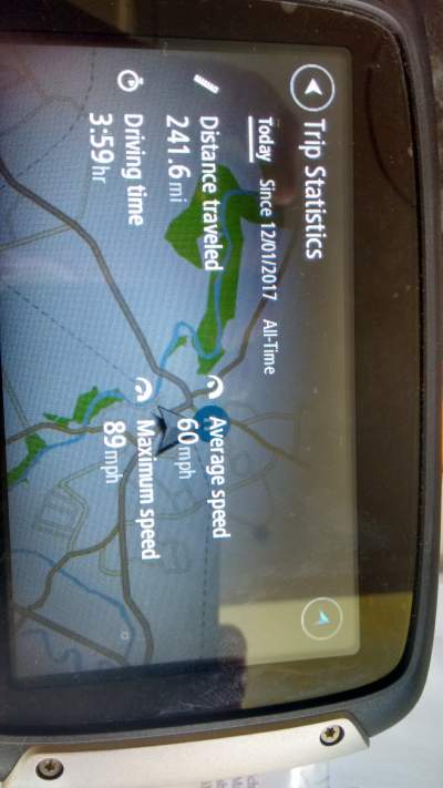

- Posts: 2730
Re: Top speed on a Strada?
Both taps on...
- IMG_20180610_162656683_HDR__1607550973_86.155.150.23.jpg (30.87 KiB) Viewed 10897 times
