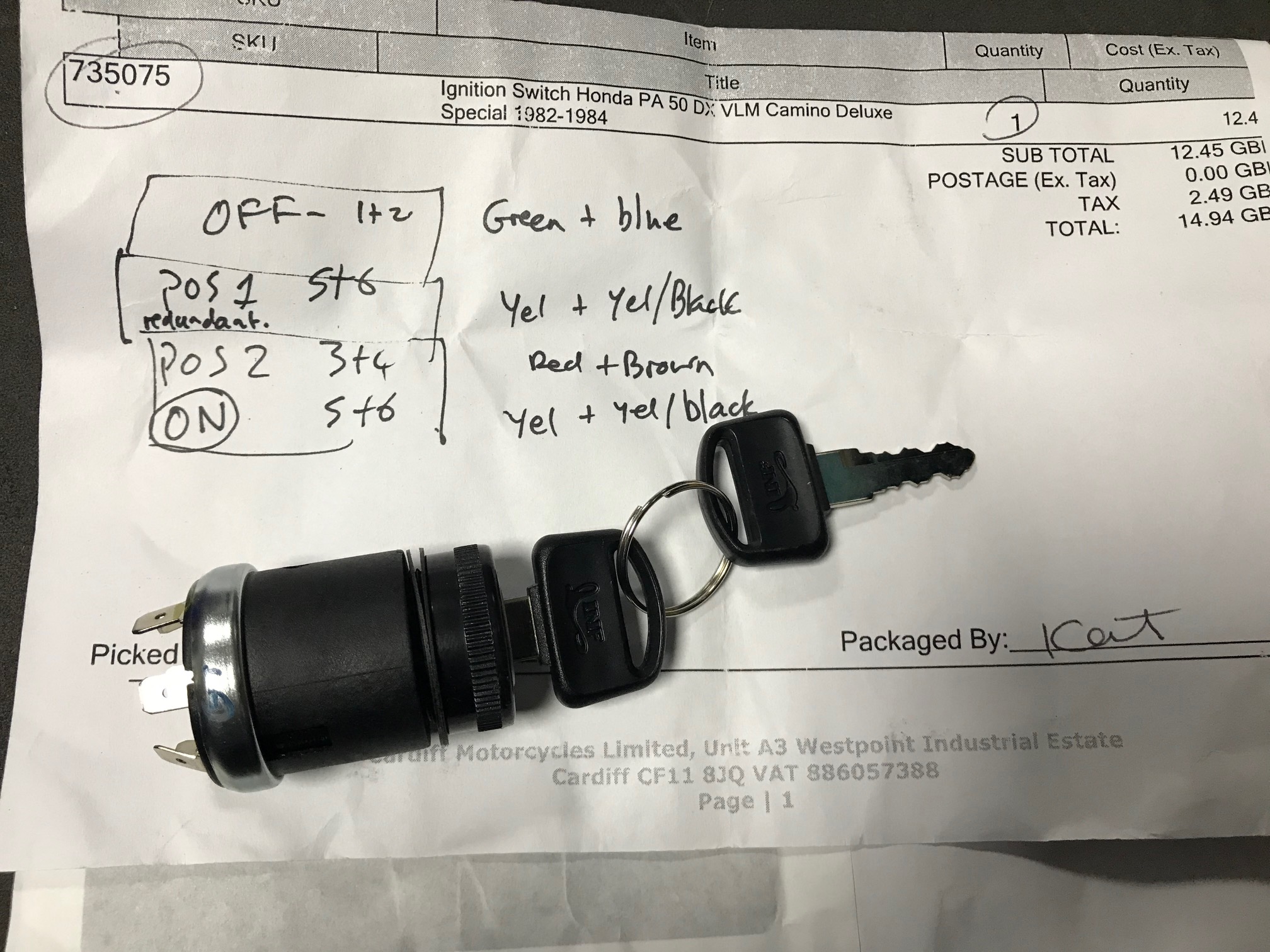

Simon, not sure how much I can contribute as my bike is much later, but I fitted a Camino switch to my K1, wired as in the attached image.
As John says, the middle position is basically redundant.

Re: Ignition switch headache...
Simon
I PM'd you but Tom's reply agrees with what I have except I have the 3/4 pair and the 5/6 pair swapped
which is functionally the same as the middle position is redundant. However that's for a six pole replacement post 1977
To replace a 5 pole as per earlier bikes as per your 1974 bike :
terminal 1 connects to green ignition wire
terminal 2 connects to earth blue wire
terminal 5 connects to red battery
terminal 6 connects to brown switched live
The final puzzle is to connect the lights feed to the snuff box
using a double ended piggy back terminal and link wire connect terminal 3 to terminal 6 (switched live)
finally connect terminal 4 to the lights feed (grey wire or white wire)
Now you have a three position switch OFF, IGNITION+12V ancilliaries, IGNITION+12V ancilliaries+LIGHTS
PLEASE PLEASE check that the switch you have has the internal connections that we are assuming!
In the unsophisticated switch i do not think there is any reason to be fussy about swapping 1 with 2 for example.
