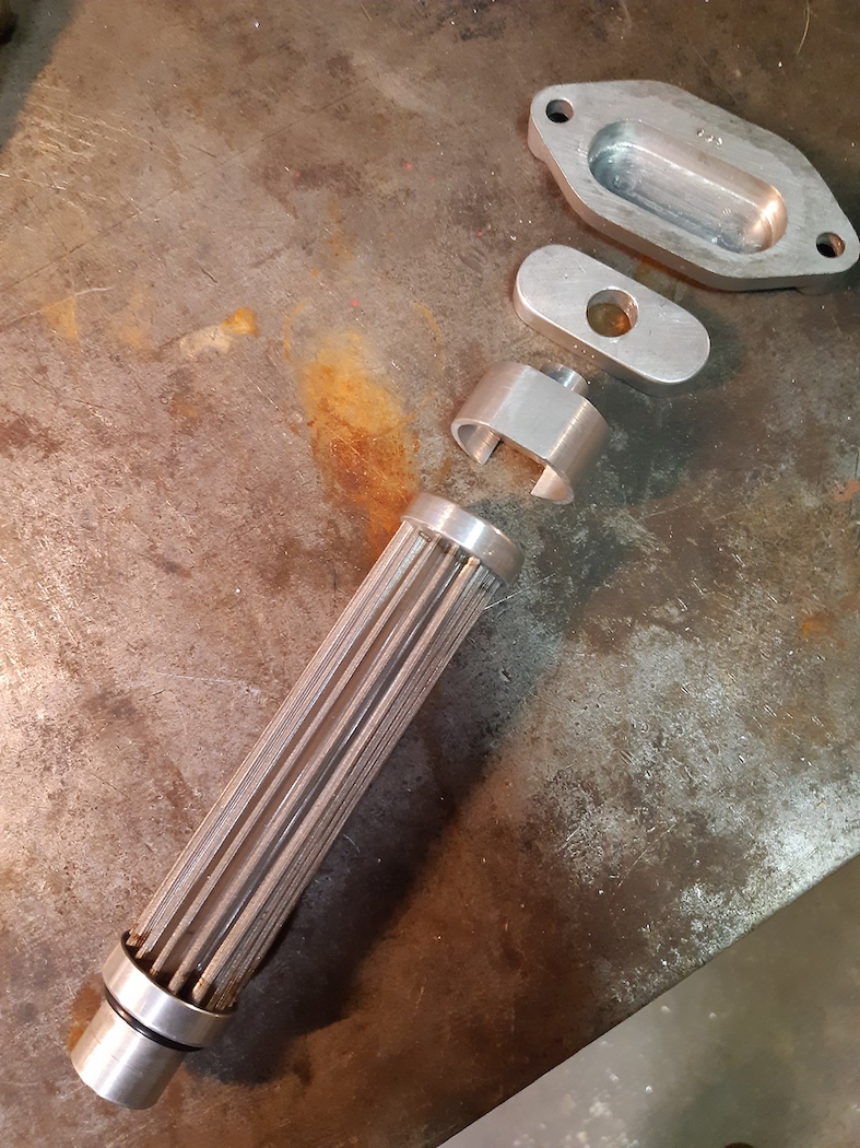

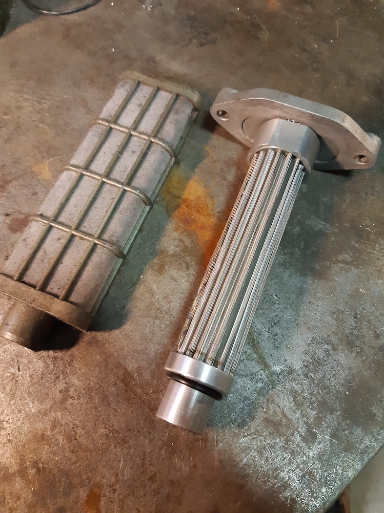

A very interesting and clean solution to improve oil filtering efficiency is this one from danish guru Soren Hansen.
https://www.youtube.com/watch?v=nqH6iLK ... 8renHansen
from min.1:37 ( anyway all his videos are interesting.)
I made my own version. A little simpler.
- 20200419_200405 copia.jpg (347.63 KiB) Viewed 13123 times
- 20200419_200556 copia.jpg (357.26 KiB) Viewed 13123 times
