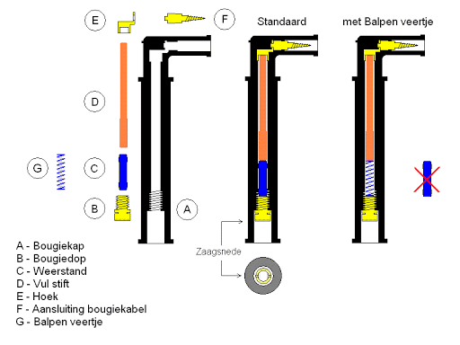

just make some youreself :mrgreen:
see this PDF for all NGK plug caps : https://filehorst.de/d/dpctFmuD
and adapt according to the picture (sorry, text in dutch). "weerstand" = the resistor & "balpen veertje" = spring from a ballpoint pen (or a copper/metal equivalent)
Job done!

NGK 1 kOhm caps also work fine, you can use this off the shelf: NGK SD01F (straight version)
