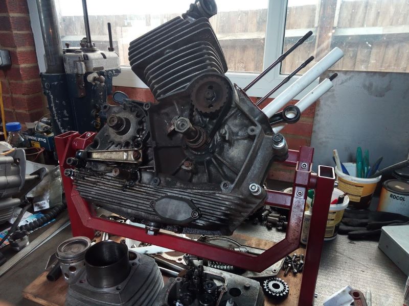

I ended up buying a really cheap "Proworks" engine stand, which came from Poland. $110.00 AUD delivered to my door. I'd already contacted the supplier to get the dimensions, so I knew the motor would fit, however, I also knew surgery would be required to make it work (this gave me an excuse to buy a gasless MIG welder). This is what I got:
1st issue - the upright holders on the base were really crooked. I had to cut away two sides with an angle grinder
2nd issue - one of the outer uprights was shorter than the other. I had to add a piece of 4mm flat steel bar underneath it
3rd issue - the outer uprights had to be bolted/welded, which makes them a permanent part of the base. They are still a little crooked, but I can live with that
4th issue - the left hand engine mount on the inner cradle was too high. I cut this off with the trusty grinder, then added an "L" made from 4mm flat steel bar to the bottom left. I drilled & tapped this to M10. I sourced a 150mm M10 bolt, cut the head off, and attached this to the cradle with two nuts
5th issue - the right hand adjustable engine mount had a M8 stud that was too short. I sourced a 150mm M8 bolt, cut the head off, and attached this with two nuts
6th issue - the inner to outer cradle mounts were a little flimsy. I made up some bronze bushes, and used longer bolts
This is the final result:
I'm pretty chuffed with it. It makes storing & moving the engine an easy task. I can also turn the engine to the horizontal, which will be good for when my crankcase splitting tool arrives.
