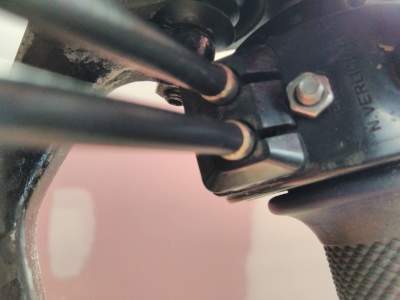

Sorry, Ben, I forgot.
Photo attached.
As per G&T, but I put the bolt inside the throttle and the nut outside...
Photo attached.
- IMG_20210507_130550__1620389552_86.159.161.35.jpg (11.19 KiB) Viewed 5503 times

cheers guys. this worked a treat
- Posts: 2730
Re: Throttle twist repairs?
Glad it's fixed. Just check the throttle returns to the closed position on release and does not stick.
