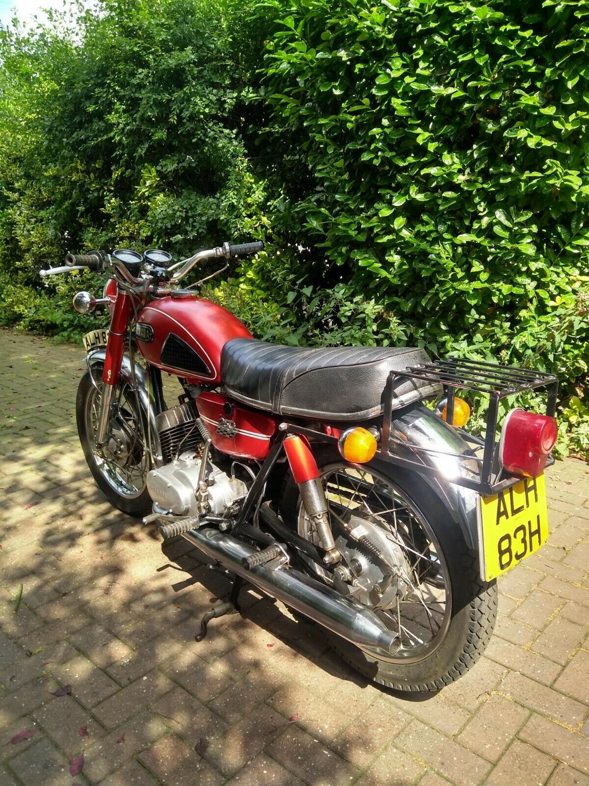

s-l1600 (5).jpg (502.42 KiB) Viewed 11769 times
Not Honda but could be Yamaha, 1960's bike had left side kickstart.
David
