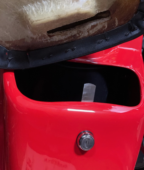

350 Sport K1 (triple disc, duck tail) has the seat retained by a lock that swivels from the top of the tail unit into a groove cut in the seat base, with the seat pushed hooked into a tongue at the front, like the attached picture.

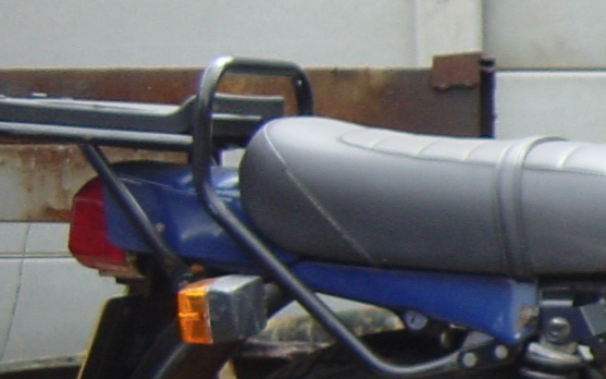

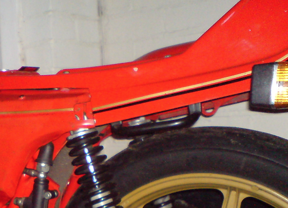

I assume from your description that yours is however like the other K models (K and Stradas) had an arrangement more like the 500 with a hinged seat and a lock on the side of the frame. My K1 has the plate for the lock and the rollovers of the seat hinge so I don't expect they bothered making the frames different for either variety. You can see in the 2nd picture the empty hole on the far side of the frame just behind where the grab handle is where the lock would be, were it not a K1. And in the 3rd picture of the blue K strada you can make out the lock in the place and see the different hinged seat and tail unit style.

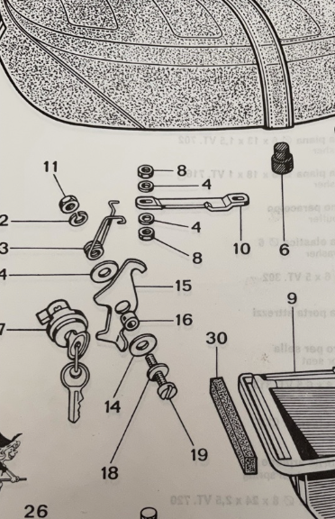

I would imagine (but not sure as I don't own this style of lock or a late 350 parts book) that the lock on the non-K1 K 350s and stradas is like the 500, in which case the final attachment is a pic of the 500 parts book showing the lock.

Thanks for swift response Tom, I didn't realize it had a key lock arrangement a lot to it really ,which on my bike is missing , just a hole in the frame were it should go and no latch mechanism so back to the cable tie , great pictures by the way it clears the mystery of what is missing on mine and how it works thanks Muller.
