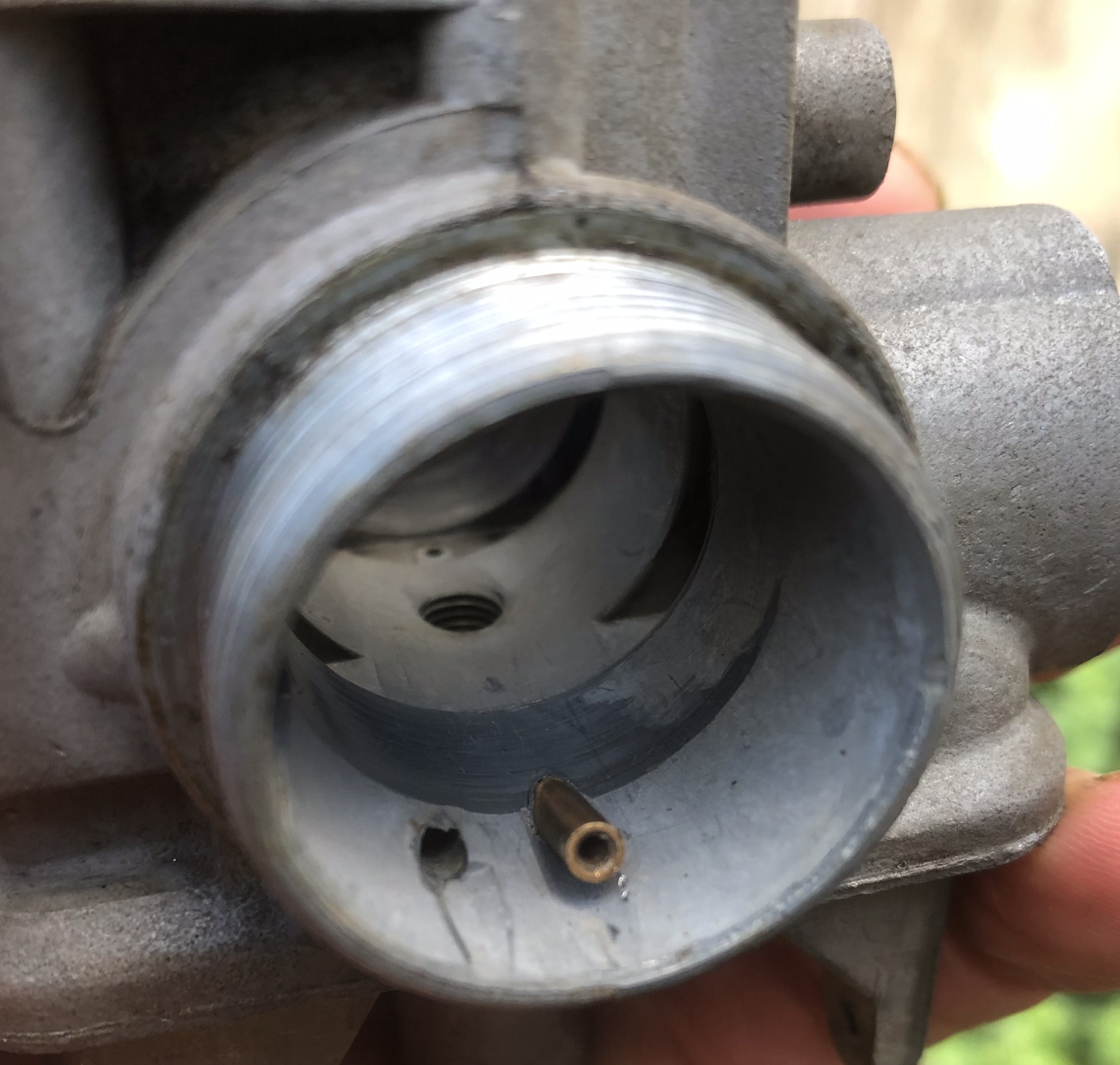

Re: Little brass tube in carb throat
See pic attached VHB25BS carb.
Oh yeah, that ones supposed to be there. I thought you meant pointing up protruding from where the atomiser meets the Venturi.
No idea how you’d get that out without damaging it. You’d have to check with fluid or air where the drilling goes but I suspect it feeds the idle/progression circuits.
It's called the air brake it can be removed but as it easy to clean on VHB(Z) carbs I have never needed to. It's purpose is to feed air into the atomizer if it is blocked the atomizer does not function correctly.

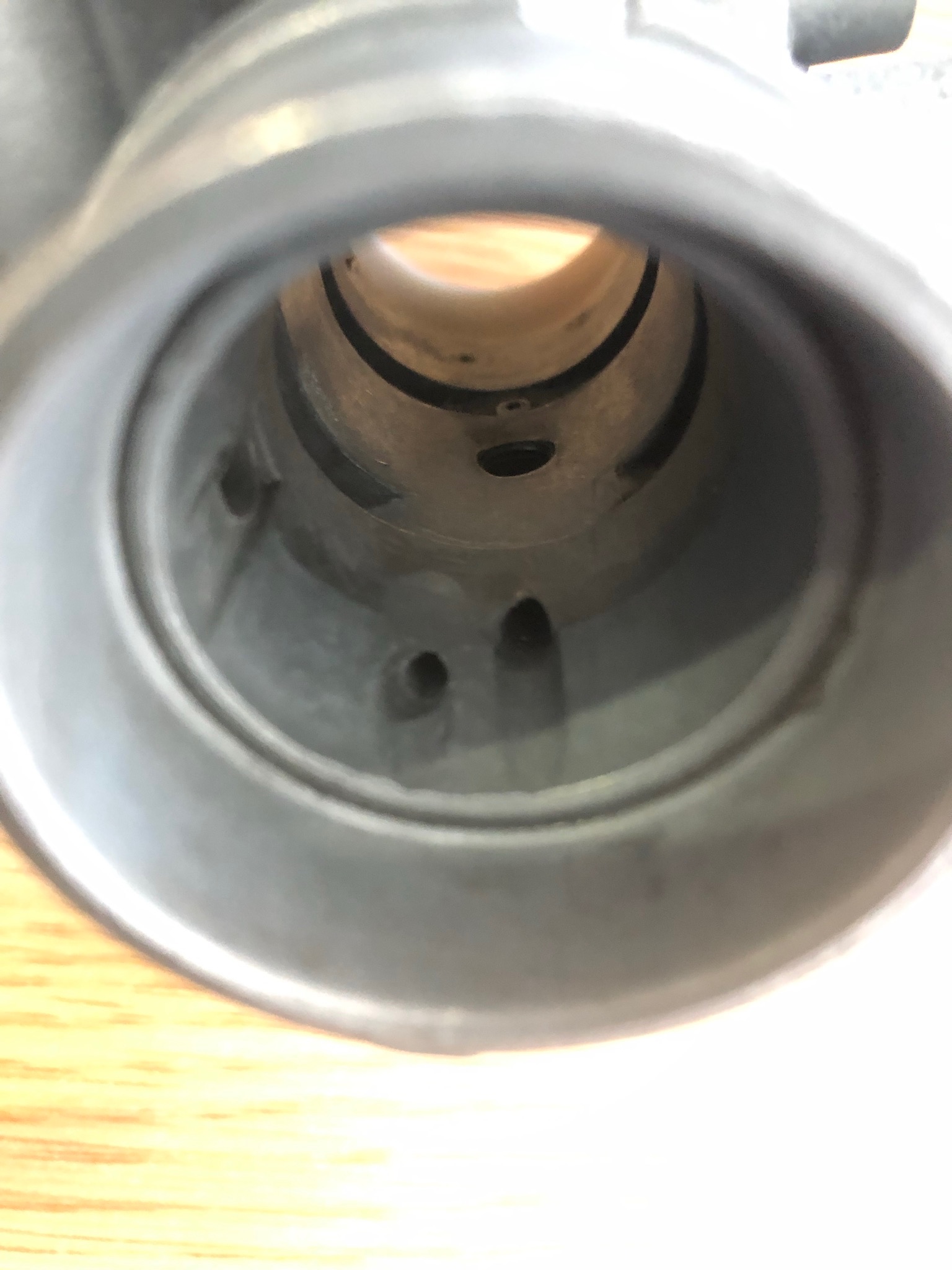

Understood on the air feed to the atomiser. The existing body (being changed as the jet block split) has the pipe. The replacement has the passage but no tube (see pic). Just wondering if the lack of tube matters?
Look up those holes with a torch , I would think you should see there is a “ pinhole” narrow brass fitting in both orifices one for pilot and one for atomiser. It is possible to just see the needle passing with a good light. A squirt of carb cleaner up each should appear if not blocked. A blocked one may respond to a carb wire or similar from a violin or guitar.
Both holes clear. Just interested in the purpose of the tube and if some carbs had it while others didn’t?
