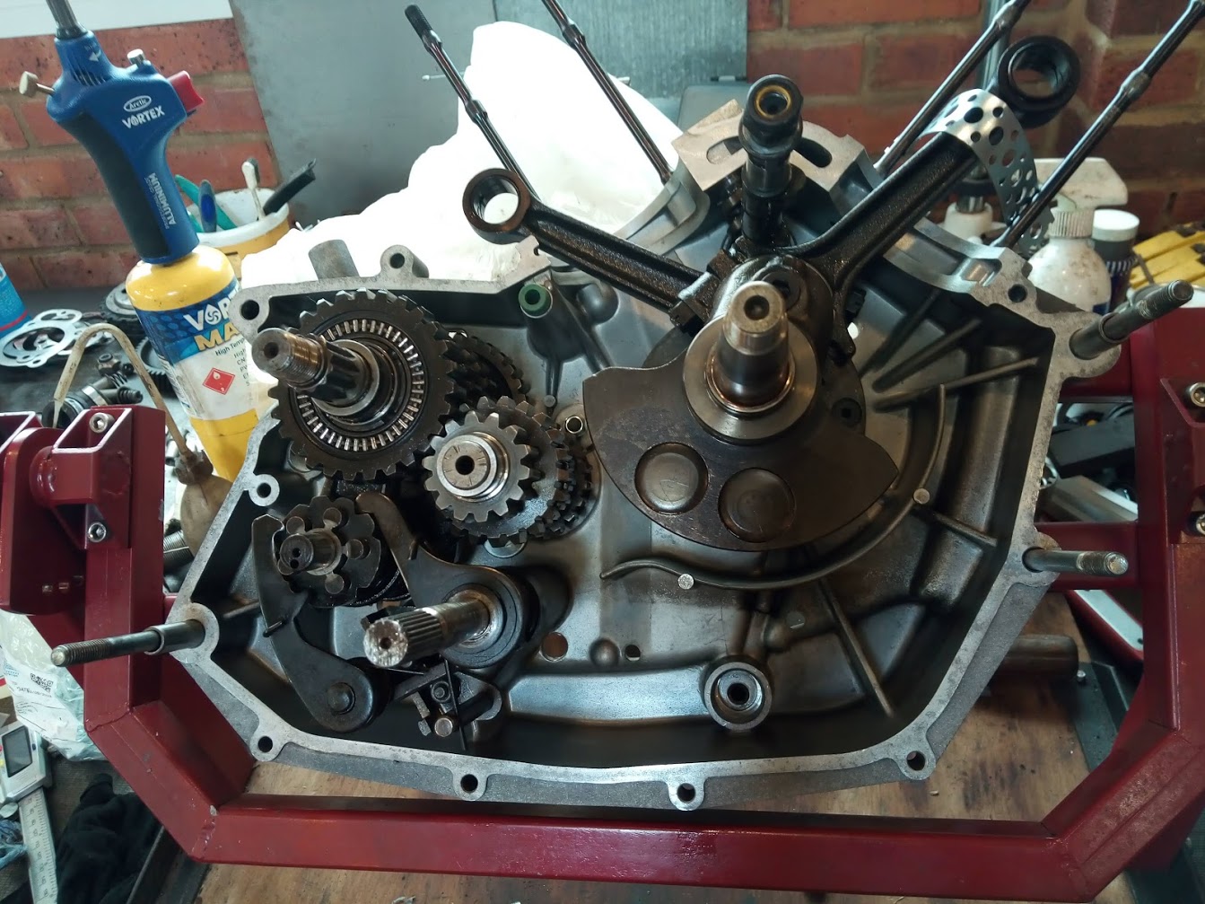

Ok, thanks. That is the conclusion I have come to. I assembled it incorrectly. I did add the rubber, but was confused by the hex in the wet side. Not a big deal as it takes 45 minutes to disassemble the clutch side. Just waiting for the parts to arrive and put it back together.
The fears of a knackered plain main bearing have gone. I thought it was the main bearing oil seal. The oil came out with no metal in it.

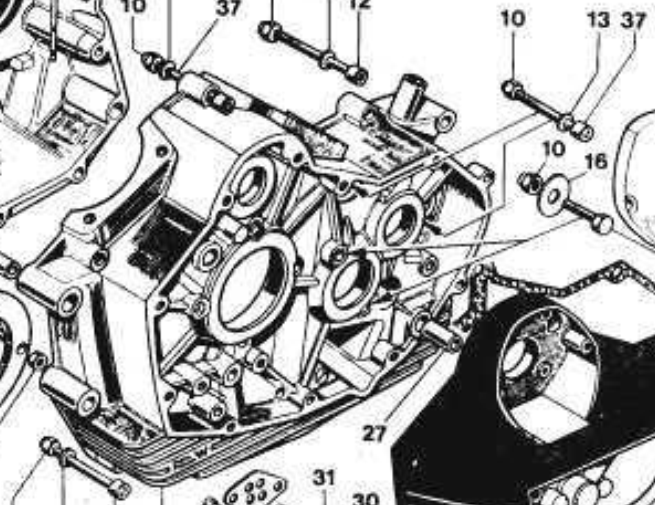

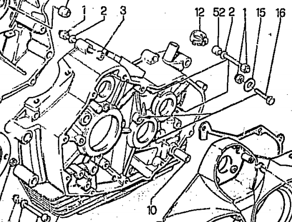

OK, I had to go and check and it appears Morini may indeed have changed their mind about which way the bolts go through.
One of the dry side recesses on the 500 Sei cases in my picture has a hex recess, but the other one doesn't. The clear hex recesses are on the wet side.
The drawings on the parts microfiche differ. Early ones show the bolt heads on the wet side, but later ones on the dry side.
They may have changed it just for ease of assembly. I can recall having problems getting the nut to sit in the hex recess.
In any orientation, I'd have the copper washer under the head of the bolt.
