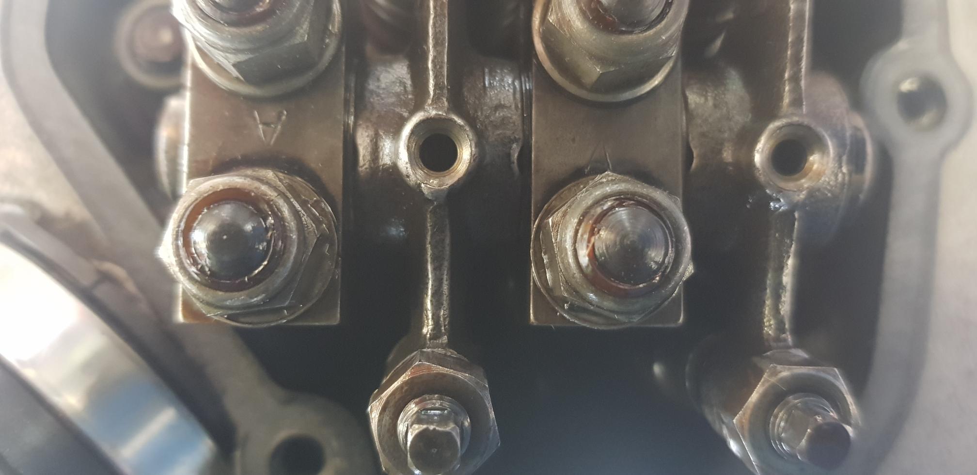

My only query is on the rocker nuts - If I've read your post correct Harry then you say the 7mm rocker nuts are not Nyloc - but I seem to have them installed, perhaps a previous owner upgrade?
Thanks again.

What you have installed is correct, the trunnion block stud nuts are M7 thick nyloc.
The adjusters are full nuts M6
By the way the upper face on both blocks is marked A (Anteriore) for upper because the blocks are asymetric,
I can see one A but not the other but its probably the photo isnt showing it, but worth double checking.

Thanks Mark, thats clear on the block post studs, I misread Harry's post.
Yes, both blocks are marked A but installed opposite - would this be right or OK? Can't seem to figure this out from the Blue Book?
- Rockers3.jpeg (139.7 KiB) Viewed 4541 times
Re: NYLOC nut types
That is Ok, so long as the A is uppermost, I couldn't see it properly in the first picture!Yes, both blocks are marked A but installed opposite - would this be right or OK? Can't seem to figure this out from the Blue Book?
