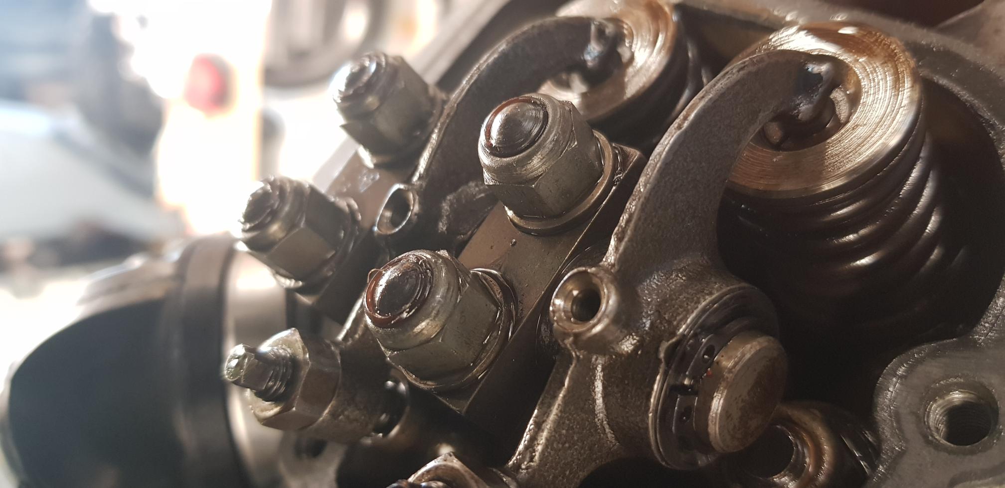

My only query is on the rocker nuts - If I've read your post correct Harry then you say the 7mm rocker nuts are not Nyloc - but I seem to have them installed, perhaps a previous owner upgrade?
Thanks again.

Re: NYLOC nut types
Posted: 27 Jul 2021 10:07
by mbmm350s
What you have installed is correct, the trunnion block stud nuts are M7 thick nyloc.
The adjusters are full nuts M6
By the way the upper face on both blocks is marked A (Anteriore) for upper because the blocks are asymetric,
I can see one A but not the other but its probably the photo isnt showing it, but worth double checking.
Re: NYLOC nut types
Posted: 27 Jul 2021 10:44
by baybell
Thanks Mark, thats clear on the block post studs, I misread Harry's post.
Yes, both blocks are marked A but installed opposite - would this be right or OK? Can't seem to figure this out from the Blue Book?
Re: NYLOC nut types
Posted: 27 Jul 2021 14:18
by mbmm350s
That is Ok, so long as the A is uppermost, I couldn't see it properly in the first picture!
