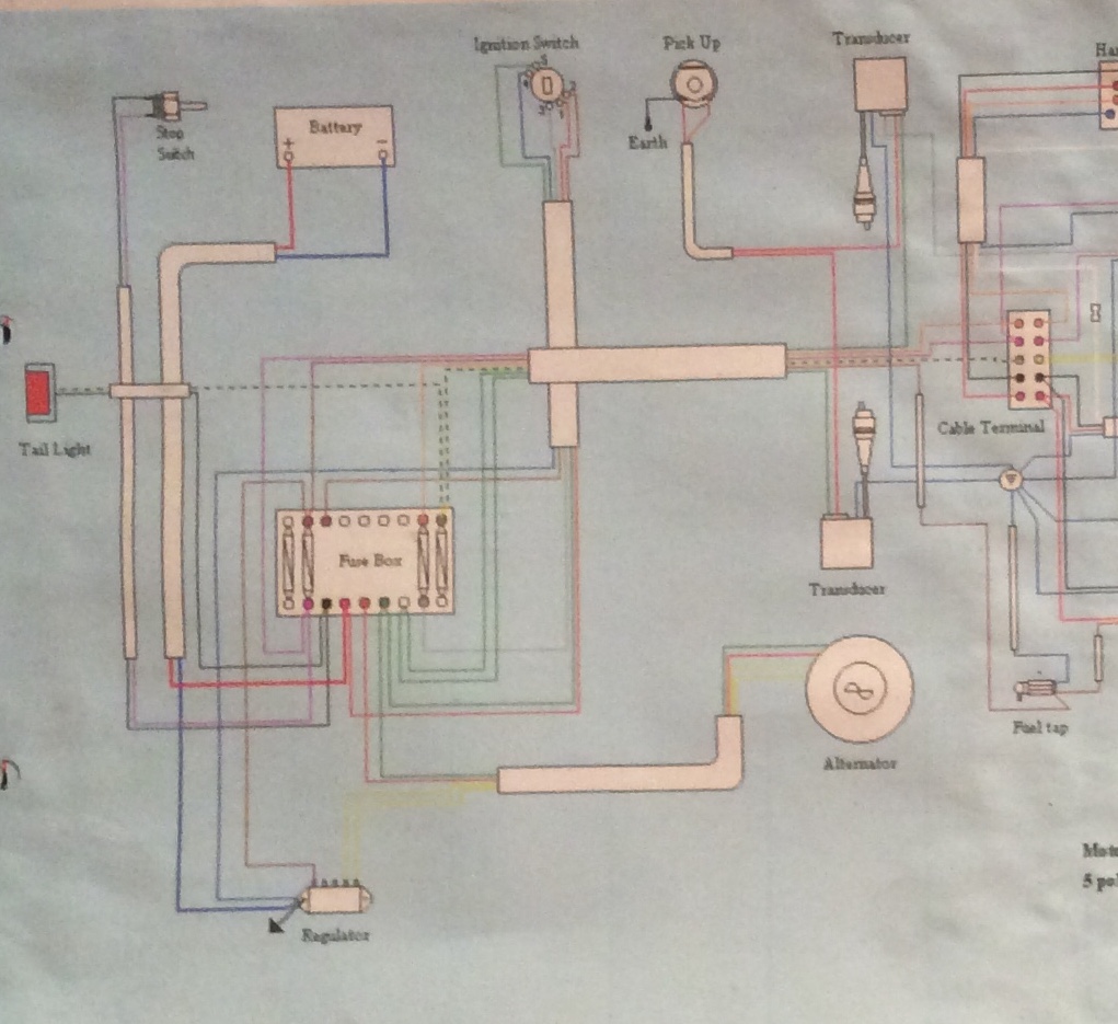

The ignition switch in the off position shorts the green wire to the blue wire. In both ON positions it disconnects green from blue.
Conclusion: If the engine continues to run with key in OFF position then the continuity of the green to the switch or the blue which goes to earth is not there.
The two problems can be related.
The not charging situation may be because the switch is incorrectly wired or faulty. The regulator must have 12V connected to the brown terminal or it will not charge. Check that the red (from Battery) connects to brown (to fuse box and hence regulator) in both ON positions.
You need to check every connection to/from switch with respect to the wiring diagram, also check each position of the switch that the connections internally are correct.

Found the issue in poor earth so switch not earthing! So all good there. In terms of connections to regulator the wiring is as per Blue service manual - see pic - so brown from fuse box to regulator as required I think. And red from battery to fuse box. Cheers
