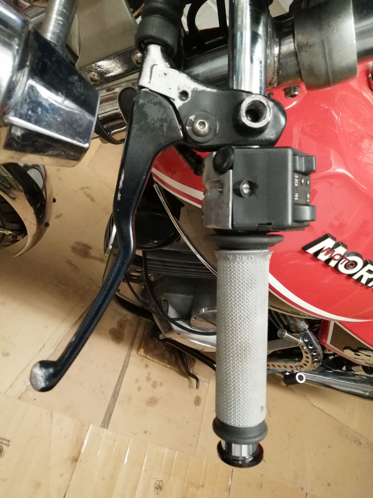

Hi: The clutch lever fitted to my newly acquired bike is non-standard, and its mounting fits between the electrical switchgear and the clip-on grip. Consequently, the switchgear is further away and difficult to use, and I’m unsure as to whether I’m getting the correct cable pull for the clutch.
Can anyone advise the correct cable pull from a standard lever, or make recommendations for an affordable and available substitute. The cable pull on my current (non-standard) lever is 17.5 mm, fully-closed-lever-to-fully-open. Thanks, Tim

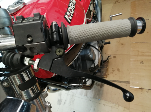

I bought a replacement. It is made by Domino. I think I bought it from Ducati Paddy.

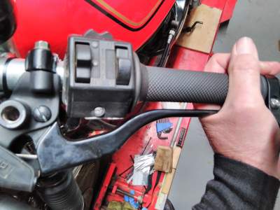

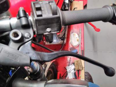

Thanks Mickey, especially for the most helpful photos. Yes, Ducati Paddy sells one, that appears slightly different to yours (yours has a wing-mirror boss): www.ducatipaddy.com/Levers#&gid=1&pid=1. A quick Google has shown there are many Domino lever variants: www.roadraceperformanceshropshire.com/c ... ies?page=1. However, ever helpful Doug at Mdina Italia kindly sent me a used item (with a little gravel rash), that I now see is also a Domino product, so I will explore whether it fits, or can be made to fit. Incidentally, were you able to use a standard cable and was the cable pull sufficient? Tim

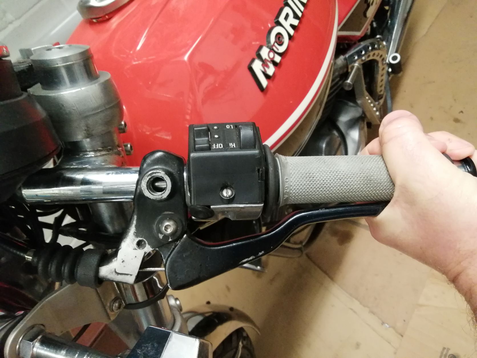

Thanks Mickey. Inspired by your post, I successfully cleaned up, fettled and fitted the used item sent by Mdina Italia, and luckily the standard Venhill cable for a Morini Sport fits. I've yet to take it for a test ride... and touch up the paint! Nonetheless, I've noted Paddy as a potential future source. I assume you are aware of Venhill for cables, but just in case: www.venhill.co.uk/catalogsearch/result/?q=morini. Thanks again, Tim
